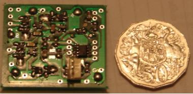

This is the latest version of the cell equalizer PCB. All loaded, tested and calibrated. Had to cram a lot of components onto the available space and eventually used every I/O on the picaxe micro. Multi layer board and DS:SMD allowed the PCB to shrink somewhat. It helps when the cct has low consumption. This board is to equalize 4 cells as well. Firmware has used most of the EEPROM as well. This size is probably the limit for hand soldering. Will have to look if a chip format is feasable.
Here is a picture.
Trev will need 15 units for his EV main battery pack and I am hoping for a successful outcome with it.

That looks good.
The issue with BMS systems for self conversion enthusiasts like myself though is that most are pretty savy, and don't want a magic black box/circuit where no one knows what's going on inside it. How long will it be supported/available before the inventor turns up his toes or loses interest?
Detailed specs and how it works, possibly even source code etc would be expected in current EV community IMO.
You might find a market for it in more commerical conversion setups as part of a complete system for the more normal man on the street, not the sort of people who frequent this type of message board.
Good luck anyway. I'm keen to see your results.

  retepsnikrep said   That looks good.
I see the battery equalizer as similar to the battery. You did not make the battery cells in your EV. You just bought them. I see the battery cell equalizer fits in the same category. The same goes for the speed controller. Your Honda insight has a factory unit. You did not make a new one. An enthusiast could add these units to their own battery, as this would require just wiring, following a precise procedure. I would think units should be installed by a trained person, as incorrect wiring will destroy a module. Warranty would be difficult to honour with a self installed unit. I know how easily this type of cct is damaged. Damage will occur if a mistake is made during wiring up, rendering a module useless, but once connected to the battery, then it is very reliable unless environmentally compromised. I expect units will become available once a packaging regime is sorted.
I doubt a savy EV enthusiast would be comfortable soldering the 600 or more black spec components needed in a typical EV setup.
  retepsnikrep said   Detailed specs and how it works, possibly even source code etc would be expected in current EV community.
The specification might only be the consumption at various battery SOC levels, and maximum/minimum cell voltage limits. How the cct works is not really about source code or how fast a micro can do the maths. You may wish to know exactly how my cct works, but people I know with EV's are more interested in getting more km's per battery recharge. They don't want to monitor all the cells and have to worry if the cells are not balanced. The how does it work is a temporary interest. Once the proof that it does work
is established and the benefit of having it becomes evident, confidence rises and this component of the EV becomes a minor aspect.
I will not be directly testing on an EV. This is done independently, in an objective way. I expect results will be presented when available.
