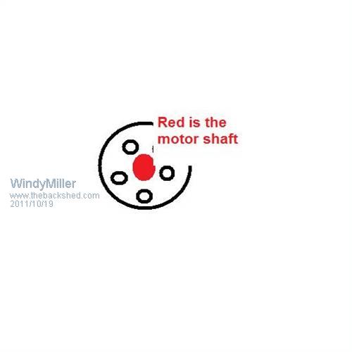

Bryan, I have been considering doing a hybrid induction permanent magnet generator using a 3 phase 3/4 Dayton? It is one of the 9 lead triple voltage 208, 240, 415 motors being I am here in the USA. It is a 1800 RPM unit and I am just wondering if you think it would work? What kind of output can I expect maybe? I do not have the resources for rewinding or machining of the rotor so I want to use this method http://research.ee.sun.ac.za/emr/files/u1/Paper29JHJPotgiete r.pdf
http://www.rpi.edu/cfes/news-and-events/Wind%20Workshop/Deve lopment%20Challenges%20of%20PM_Generator_RPI_Qu_v8.pdf
Along with a Induction Generator/ Permanent Magnet voltage regulator scheme. This is something I am designing myself at this time. I do need to get wires 10, 11, 12 brought out of the unit yet? Unless I can find the type of leads and connectors a professional motor shop would use so I can do it myself? I want to try the star, delta, jerry connections using a massive mess of diode bridges. I guess I need 6 diode bridges for Jerry as that is the connection I am leaning towards. I plan on using 50 amp 1000 volts diode bridges for their reliability. This motor has a rotor with 5 or 6 holes running the length of the rotor making it very thin and not possible to machine much or drill holes in for round magnets. But if I press in round bar magnets in the North South North method to excite the machine and make it a hybrid induction generator I should be able to use it for a wind turbine I hope? I live in North Carolina and we only get winds in the 5 to 10 MPH range. Right now in the fall and winter we have the wind. In the spring and summer we get no wind at all. So I am thinking of a gear box, or pulley and belt arrangement? The motor rotor looks like this drawing.
I have a little 1/2 HP GE water pump motor that is 3450 RPM, 115 Volts at 7 amps. With a tiny rotor which makes it difficult to put the magnets in it? I only need one North and one South pole as this motor is only a 2 pole machine. However I cannot find any proper half curved magnets anywhere? I am using this article for this machine and it's conversion. http://www.otherpower.com/otherpower_wind_alternators.html
I am only experimenting right now and not looking for any serious output as I am only trying to learn at this point about induction motors and permenant magnet conversions? Blades and towers, etc. I started out 4 years ago on this project and I need to get one of these machines running as I am losing confidence, and faith in myself regarding these projects as I need to just get one unit going to watch and study.
The 2HP Dayton I want to use as a induction machine driven by a gas engine so I am not thinking of converting it for wind power at this time. However if my above scheme works I may go ahead and make a bigger wind turbine by using the 2HP machine.

Posted: 11:11pm 20 Oct 2011

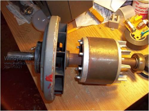

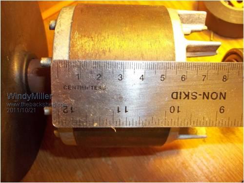

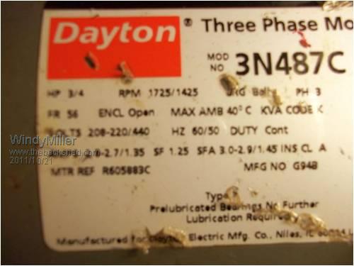

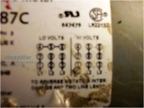

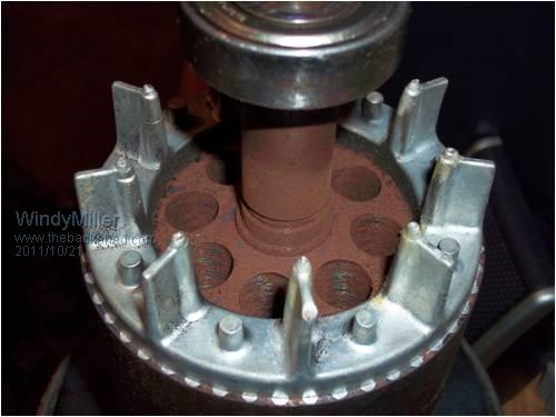

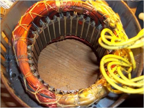

GidDay Everyone! I have decided to post some pictures of the motor I am working with in the hopes that what I am trying to do becomes clear? The two links above are the core of what I am trying to do. This link PMIG is the one I am using the most as it shows the PMIG stator and the flux fields. I just don't see why putting round bar magnets in the holes seen in the rotor would not energize the machine enough to start it generating and then use the normal cap method for full power from the machine? Should it not cause the unit to start generating at the slower speeds?
