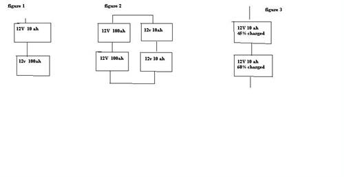

ok so i know figure one is bad, doesn't work, but i'm talking about figure 2 which is not ideal but i have heard conflicting answers as to if that will work or not. Will the 100ah batteries just consume more current than the 10ah and both charge at the same rate?
and then in figure 3 since we don't have a nice easy little meter telling us how much a battery is charged is there a way to do that so that one battery doesn't get damaged while charging.

As i said before i am not the best person to answer this, but as no one else has jumped in with a answer, i will have a go, so not to leave you hanging here.
I dont see a problem with fig 2 as the combinded Ah will be 110 and over all the charge rate will equal out.
Both battery banks will charge at the same rate and reach full charge together.
Same goes for discharge, they will discharge together.
Fig 3 is a problem however.
Each battery needs to be equalized.
If both were charged to full capacity on 12 volts before being placed in series than this would not be a problem situation afterwards.
As both are of the same Ah capacity they would then charge/discharge together.
This is where problems start with using secondhand batterys of not equal usable capacities. The bank will only be as good as the weakest link (battery)
Like the old saying "one bad apple can spoil the lot"...The weak link can prevent the other batterys from discharging to a given level and also inhibit them charging to full capacity.
Think of it like putting 1 flat battery into a flash light with 3 new cells.
The 3 new cells are only as good as the flat cell.
I have seen many 24 volt truck batteries stuffed up because two way radios have been connected to 1 of the 2 x 12volt batteries.
The radio draws one 1/2 of the battery bank down lower than the other half, and creates your figure 3 situation.
Then 1 battery gets deemed as no good and replaced, this then reverses the situation and before long the second battery is replaced reversing the situation again and so on. With a grumpy truckie complaining the batteries are no good.
Solution......Change both batteries together and run the radio off a 24v to 12v regulator that draws from both the batteries keeping things equalized, long battery life and a not so grumpy truckie.
In the case i quoted above the cost of the 24v to 12v regulator was peanuts compared to what was spent on large battery replacements over a short time.
Morral of the story KEEP.. things equal where you can. ( and truckies dont make the best electrians)

Posted: 03:17pm 23 May 2010
10Ah vs 100Ah is a fair difference in capacity!
Part of the problems that could occur will stem from the fact that the large battery will have a much lower internal impedance than the smaller one
When connected in series, the voltage of the smaller battery could all but collapse compared to the larger battery when delivering large currents under load.
This results in uneven discharge as more energy will lost in the internal impedance of the smaller battery, a similar thing will happen in reverse when charging.
In Parallel is not as bad, but could be a problem when charging, as 40A for a 100Ah battery is a nice rate of charge but is likely to more than a 10Ah battery could handle, resulting in distruction of the smaller battery.
Also batteries in parallel tend to discharge into each other as there is alwasy small differences in the state of charge between the different banks of cells.
