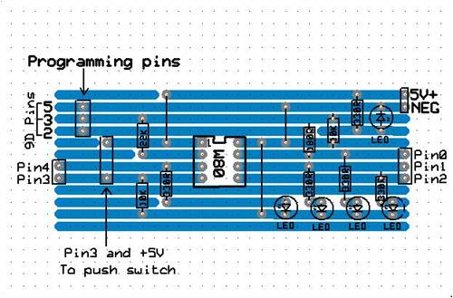

Posted: 12:11pm 17 Jan 2010
Hi Simon,
I threw together a bare bones 08m picaxe circuit for on veroboard.
Many other things can be added as you need.
It will allow you to fire a picaxe up and control a few leds to start with.
There is no voltage regulator in the circuit so you will need to find a DC power supply of 5Volts.
3 x AA batterys will be ok as this will give 4.5 volts and the picaxe will work down to 3 volts.
5 volt is the maximum input voltage.
The output pins will only handle about 30mA and will only drive a led so any greater current load will need to be controlled with a transistor or likes of.
This should give you a starting point to have a think about when your goodies arrive.
This PDF here should be a clearer image than the screen shot.
.2010-01-17_221835_Veroboard_08M_circuit.pdf
PeteEdited by Downwind 2010-01-18
