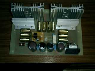

An inspiration to get on with my own heater. Considering what 65-70W (modified PC PSU) could do, I'm really looking forward to what the present 1kW project could achieve. And after that....2-2.5 kW is the goal! At present, the 1kW inverter is nearly finished - gate drive circuit will be next.
