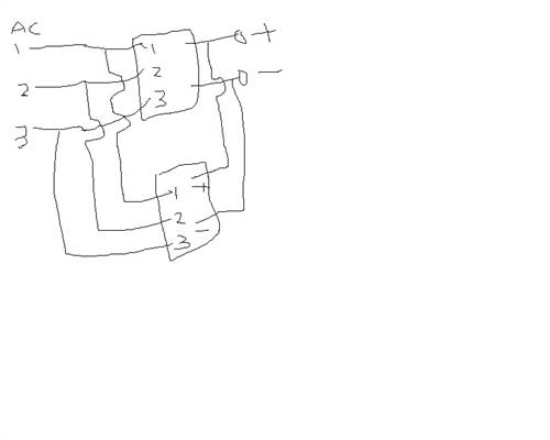

ok so i dont stuff it up
is it as simple as i have drawn (yes very quick a nasty)
thanks
Posted: 02:19pm 22 Dec 2009
Yes your drawing is correct BUT please take note of the other posting regarding the diode voltage drop differance that i neglected to mention.
I would say if all you required was around 25 amp and wished to share the load across 2 rectifiers to keep the package heat down and not run one to its upper limit, then parallel conection should be ok.
In theory parallel connection should give you double the amps, but as Robb pointed out it can cause thermal runaway which could cause one rectifier to do all the work and resulting in letting the magic smoke out.
All will most likely work well until one day the current goes high enough for long enough and then "Poof" the magic smoke is gone.
Good luck.
Pete.
