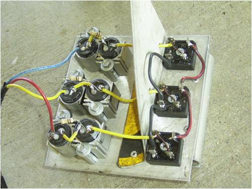

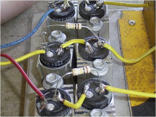

I have used the disign that Gordon posted some time back and need a little feed back. I have used 6 220uf caps back to back ( 110uf real) 180 volt caps and they feed into 3 bridge recs then ito the batterys. It works well on High voltage gens but only shows amps at high gen speeds at low voltage( 12volt )
It is connected to 7 groups of 6 polls STAR.

The pictures you have posted are not of a capacitor voltage multiplier, but just a series cap connection. This is used to unload a windmill that would be normally stalled by the load, and needs reduced loading to get going. The outputs you quote are expected in this arrangement, but this is not the optimum arrangement.
You have heatsinks on the caps????? Is this just to make mounting easier?? I use hot melt glue, and glue the caps into a block, and then wire them up. If the caps get hot, then the voltage rating is not high enough, or the power required to be passed is too high for the cap size.
I have series caps as the main power passing component on my 48V AxFx mill, but these are 200V and 2300uF. These are in addition to cap voltage multipliers.
the scenario you describe above is not the way to best use caps. Rewire the coils, so that the battery cutin voltage occurs at approx half the expected maximum rpm. What is the expected maximum power output of the alternator, and what is the maximum rpm, and pole count of the alternator and system voltage??? The uF and cap voltage rating required can then be estimated.
The best matching occurs with an alternator wired for the top end performance, that has poor low winds performance. Normal rectifiers are used for the bulk of the power handling. A capacitor voltage doubler, and possibly a capacitor voltage tripler can be added to extract more power in low winds, when the rotor would not be spinning fast enough to achieve normal battery system voltage cutin.
It seems as though you have some more work to do.

That doesn't look any thing like a voltage doubler if that is what you are trying to make , the set up you have there appears to be a series cap connection and I would think the uF is mabe a bit on the low side , I am only guessing that this is the problem as not much was done with testing caps at 12v , but I think Glenn is looking at that

do you need to match the ratings too?
I notice one of the caps has 180V on it and another 250V.
These are the type used un PC power supplies right?
Gordon would you use this size in the tripler
(ie the 110uF at 180+V as shown) on an F&P (48V 2p7s)?
.....if so i can get these caps in hard rubbish readliy for free!

Ok, Im still yet to get my head around this cap system to.
But a quick look at the schematic on the front pages on Caps. Would indicate your bridges are wired wrong? and need 4 of them not 3.
The cap's you require another 6 configured the same as you already have to make up the multiplier.
Have a look at the schematic on the front pages and look at the one with the bridge rectifiers in it.
HERE
Labelled.
[ The circuit below uses the common 35Amp bridge rectifier instead of individual diodes ]
Im not sure if you understand the setup of a bridge rectifier. (if im telling you what you already know please forgive me)
A bridge has 2 AC terminals often marked with a squiggly line. Each AC input has 2 diodes connected in reverse to each other, one goes to the positive output terminal and the other to negative output terminial.
The diodes gate the AC input into +/-.
The other AC input is the same as the first, and is also connected to the + & - outputs.
This enables us to rectifie 2 AC phases.
You have both of your AC terminals connected together. All this will do is double the amp capacity the bridge can handle.
In other words you use 4 diodes to do the job of 2.
Solution:-
Add another bank of cap's.
Add another bridge.
Rewire the bridges correctly.
You should get some results then.

Notice in one of Gordons posts he uses deticated 3 phase rectifiers, yet another cct I suspect.
I have been bench testing caps and have tried both ccts, but only with capacitors I have around. I need to lash out and buy a heap to truly test Gordons doublers.
To date tho I have seen no evidence of doubling only increases are due to the increased excitation on the Gen ie when tested on a three phase supply no increase.
Gordon notice you say you tested initially on single phase can you show cct used so I can evaluate here without buying in heaps of caps?
Also Gordon can you explain how you see the double working in a 1/2 cycle by 1/2 cycle sequence?
I very much get the feeling you see caps as isolating the AC and then adding the DC outputs of the rectifiers in series. This could be achieved with transformers but not IMHO with caps.
If the cct? works as a doubler you would not need non polarised caps. but I notice no DC charging only AC.
In cct using the bridges it does as Gill observed have for one 1/2 have one cap in series with batteries returning via the other cap in another phase. this second cap in the +ve phase is meantime in parallel so could in theory charge to a different level than its discharge but the values I have here show no evidence of this.
Better shut up until I have results that can be publised
