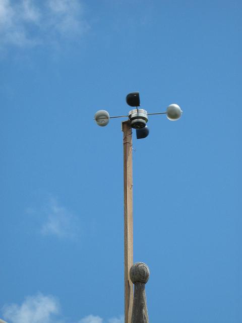

The anemometer i am doing at present is using a optical sensor out of the gutted video but im not sure on the expected life of a optical sensor out in the elements of nature.
The circuit will work for either a optical or hall sensor.
The intension is for it to be wireless data but can be used via wire connection from anemometer.
I have just finished doing the revised pcb artwork for it so the electronics can be mounted with the anemometer so just power wires need to be run up the pole to it.
I will take some photos on the weekend and post of hdd part.
As for getting the data into a computer etc. Well lets hope there is some clever folks out there that can help in this area as it is not my field.
Basically it would be a case of plugging the sd card into a card reader and downloading the data to a file but where we go from there is beyond me.
Heres a shot of the video head one on its first test flight to see how it spun and data rate etc.
It has barely stopped sinse its been up and always moving even is ever so slow.
Great bearings in video heads.
Anyways scrapped this idea now.
Pete.

Hi Pete
That looks the part to me better than those fragile plastic ones marketed on ebay and jaycar.
It looks like if it had a skirt with holes drilled around it with the sensor underneath it would last a long time, I used one of these sensors in a ignition system and it never gave any trouble even it adverse conditions under the bonnet.
When the thing is spinning it would keep water out by centrifical force.
Led could be powered by battery with solar garden light innards, plenty of those around cheap or give away when the origional battery dies.
All the best
Bob

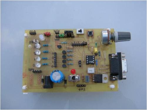

I designed a prototyping board for the 08m when i started to play with them so i could test a program and learn how these thing worked that i still use today when developing a idea.
You dont need to go to the extent i did but with this board i can use all the functions the 08m has available.
