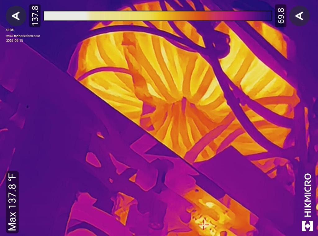

After recieving it, I ran the inverter at about 3500w for 10ish minutes and then opened it up to see what would be revealed.  (I doubt the unit is fully heat soaked, but this is enough time to get things warmed up)
Here is the transformer.  Although I had siliconed the transducer deep as I could into the windings,
the inner windings are about 40F hotter than what the sensor is reading.  I knew there was going to be a difference,
so it's good to know what it is.

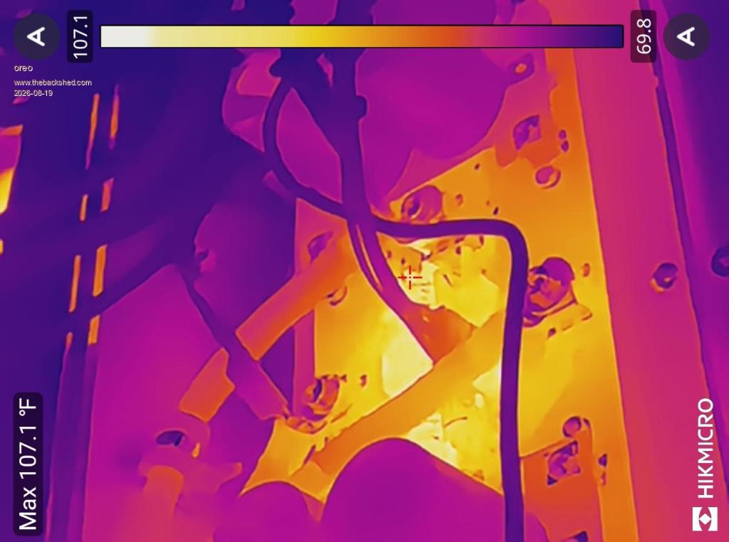

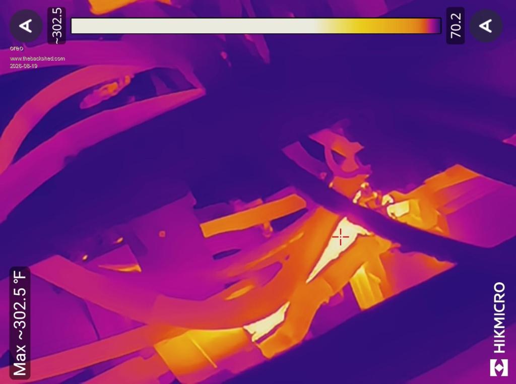

Further scanning of the rear internal panel wiring revealed the following alarming picture.
I know it's hard to see exactly what is going on from the picture, but I am pretty sure
that 1/2 of the 120v split phase circuit breaker is bad and is running quite hot.
The heat then propagates into the surrounding wiring attached to that terminal.  I still need to pull it apart to confirm as the wiring is difficult to get to without the rear panel.
Nothing else in my setup is a concern at this point, but I am quite glad I picked one of these cameras.

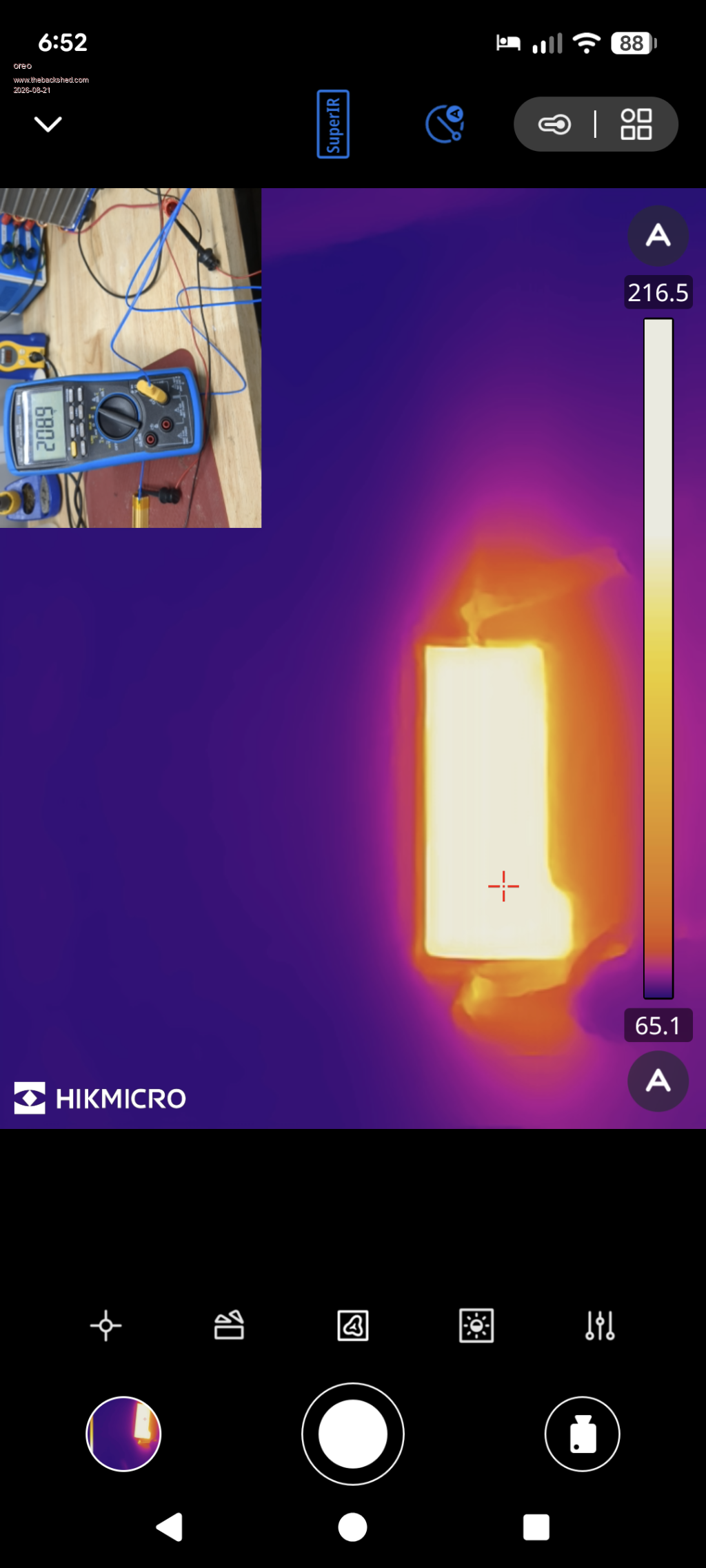

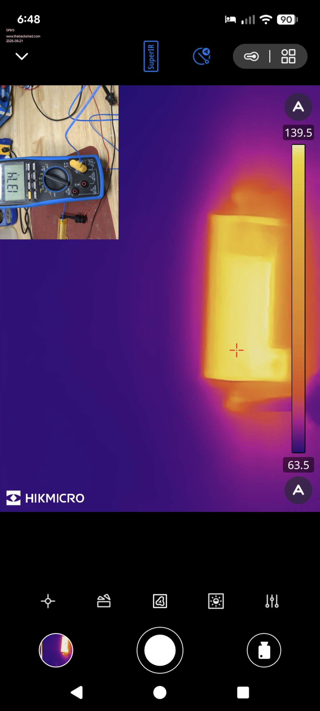

For the temperature ranges I am using, I believe the accuracy is "good enough".  If I need an accurate temperature measurement, I really should be using the RTD transducer.
They do use IR for detecting if you have a fever, so the accuracy can't be that horrible.
Here are some comparisons between an RTD/meter and the IR camera.
Greg
