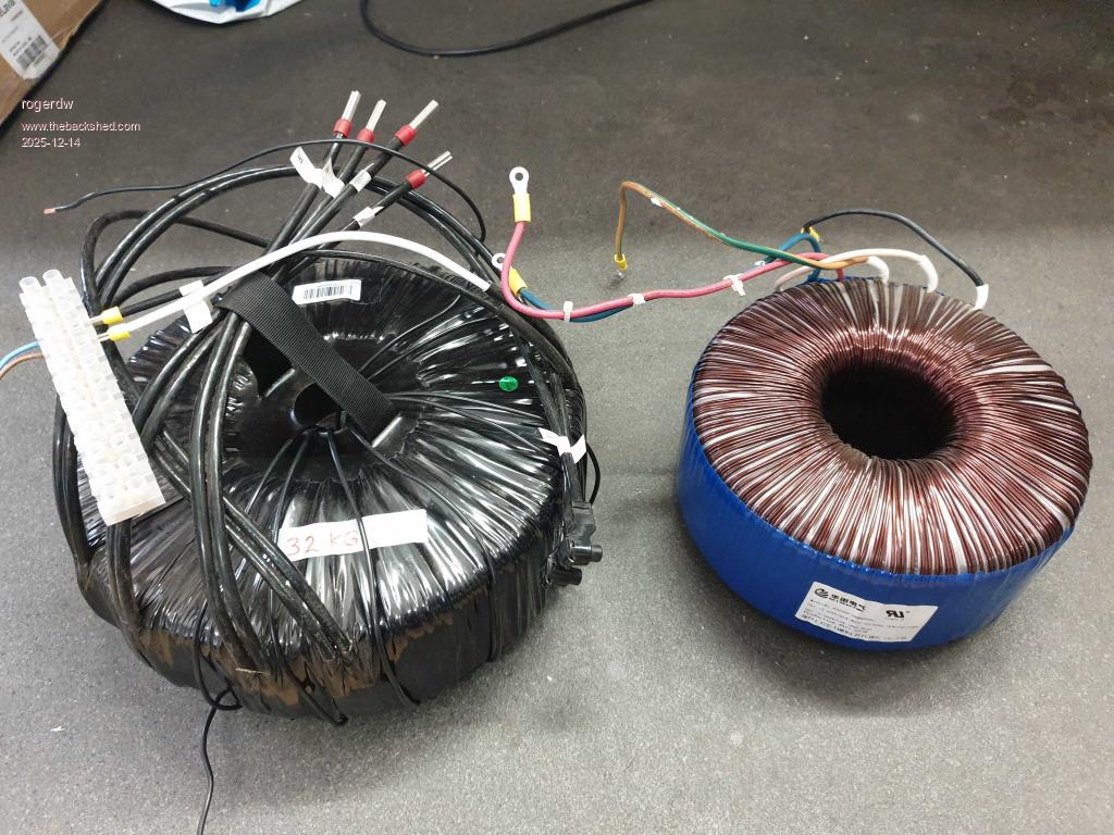

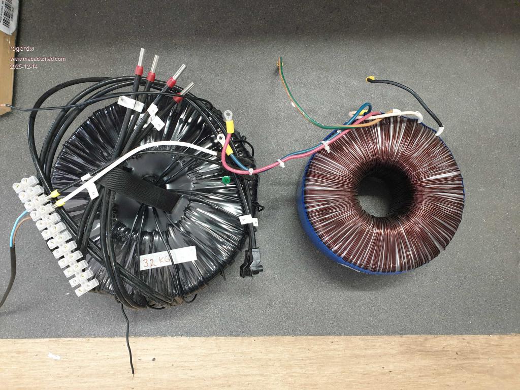

I have a largish toroid I picked up at auction that comes from an Eguana 5kW inverter.
A Canadian company that was building inverters and lithium battery systems in Adelaide, but closed up a while ago.
I understand they were 48V systems.
Anyway there appears to be one secondary winding and four separate primary windings.
With 240VAC applied to the secondary, each primary winding is at 21.58V.
I wound 8 turns and with 240 applied again, the 8 turn winding shows 11.47V
ie. 1.43375 V/T
With other guess work and manipulation, I came up with 167T for the sec and 15T for the primary. Does that sound right? Thanks.
The toroid to the right is a 3kW Aerosharp toroid, so the Eguana one is markedly bigger  ...  and weighs a hefty 32kg.

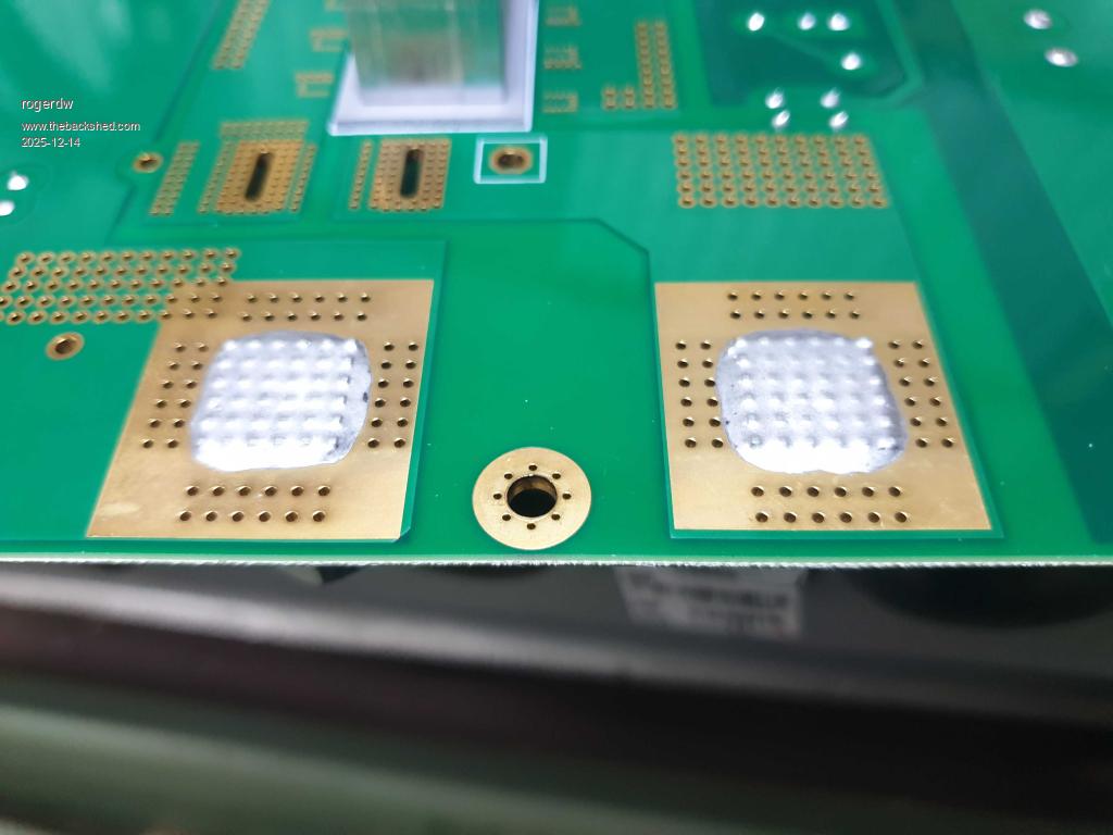

In thinking about the four primary windings, I decided to pull apart the inverter that it belongs to  ...  and there are four separate bridges (of 16 fets), each driving one winding. Each bridge has two Infineon 2ED21844S06J half-bridge gate drivers.

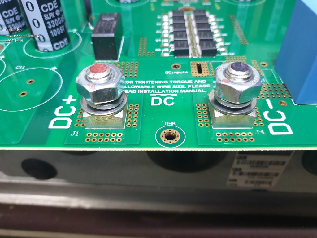

I was impressed with the DC connection terminals. Really substantial boss, thread and nut  ...  and the base has multiple pins that go through a matrix of holes in the board and are soldered in. Looks really solid to me.
