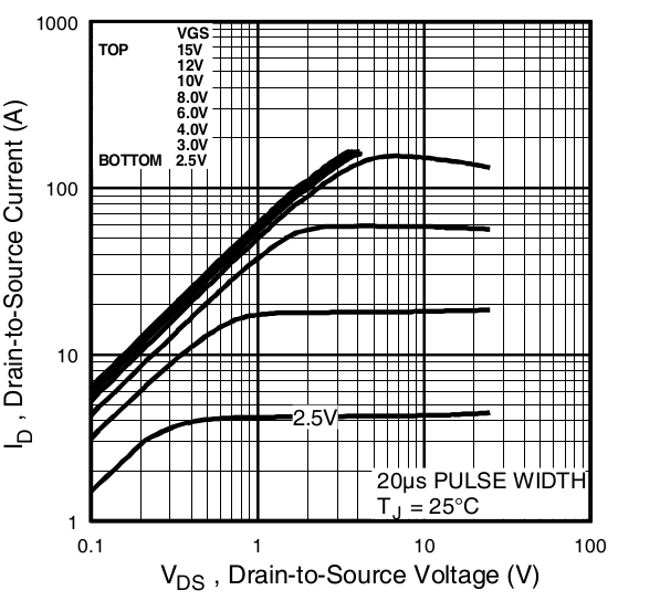

Datasheet Fig. 3 - Typical Transfer Characteristics indicates you need 5V with a 10A load.
At 100Hz switching losses are a minor issue.

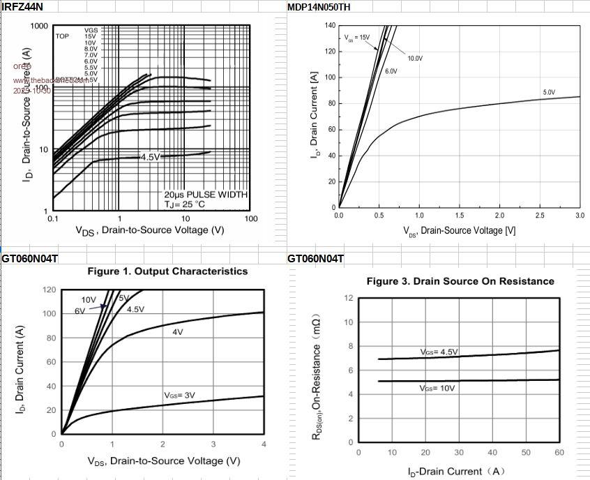

I had a similar issue, when I tried to use IRLZ44n's on the Wiseguy's nano board to drive the fans.  This design uses 5v to drive the mosfets and the IRLZ44L needs more voltage than this to fully turn on.
You can see this from the datasheet.
I had some MDP14N050TH's on hand, which do much better at low gate voltages than the IRLZ44's and I ended up using those.
You need to pass 10A of current though, and I question if the MDP14N050's will run cool at that current level with a 5v gate drive.
I went onto the LCSC website and on the device selector I selected drain current >85Amps and Gate threshold voltage (VGS) <1.5v and got 31 devices which were in stock and in the TO220 package.
The GT060N04T is one of the devices from this list which will fully turn on with just 5v of gate drive.  A device like this is what you need.

But I was puzzled by the first graph until I realised that you show IRFZ44N
when I am using the Logic level gate version which is the IRLZ44N.
