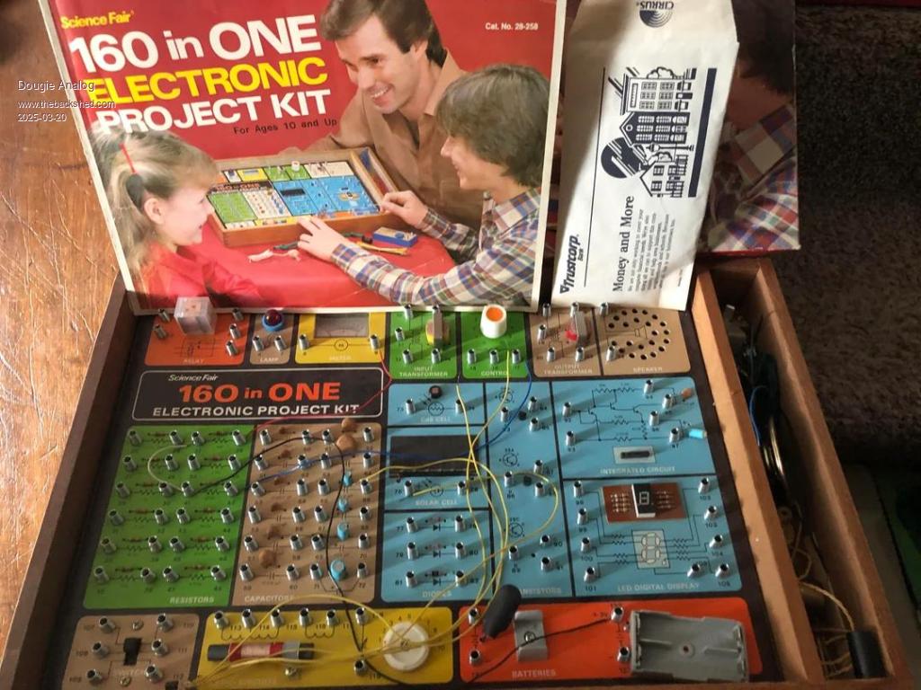

I haven't been this excited since Fonzie gave me this electronics kit.
Why won't he let my sister use it?
