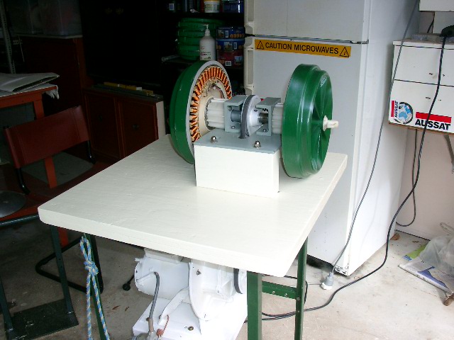

Hi Crew,, I've finally finished making a test bed for testing different re-wires of Stators and running up Neo Rotors .. I'll make an adaptor to fit the Seeley motor also -- With the gearbox (old floor polished) and 1.5 hp motor ,I get 400 rpm ..This can be changed by different pulleys .. Runs smooth ,just the normal gearbox noise..

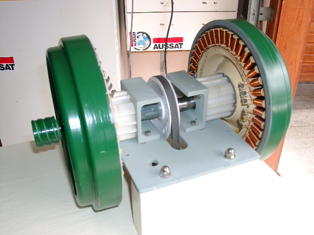

IM,, the white plastic bearing holders were cut from the bowl of the F&P ,,drilled and tapped ,mounted onto Aluminium channel which is drilled and bolted to the Aluminium plate on the top of those 2 blocks of wood to give some clearence..
The pulley is bored on my lathe to tightly fit the shaft and a small seating hole was bored to accept the grub screw in the pulley.
Lots of lathe work and scavenging of parts ... the gearbox was an industrial floor scrubber ,found discarded at the local tip..
The actual frame was an old saw table complete with rise and fall mechanism and a 1 HP 240v motor .. local tip shop ,,$20.
