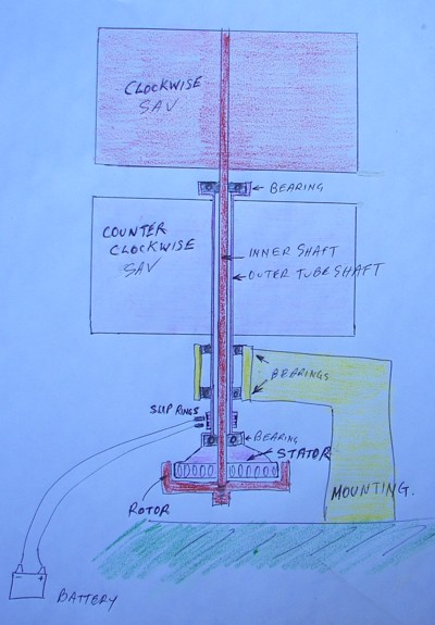

The idea is to have two counter rotating savs. One driving the stator and the other driving the rotor.
It doubles the speed of the generator without the power loss of a gearbox or other power loosing transmission. OK. So there is the losses of 4 bearings instead of 2, but that's bloody good for such an increase in gen speed.
What's more this setup is easy to mount an F&P on to and would be about right for a 2 x 200 litre drum rig.
Here's a sketch of how I see it:
Any better thoughts??
Cheers Gill _Cairns, FNQ

I have been pursuing this idea for a few months but went cold due to the slip rings for the rotating stator.Not having any previous experience with slip rings and indications from others comments were negative regarding expense.But I have a very similar design to the above concept and if slip rings are not an issue it definitely has merit.In my version the rotor is mounted by five of the ten drain holes directly to the base of the bottom Sav.A second F&P unit could be attached similar to Glenn's HWAT twin stator setup.Which might gain the best of both the torque and increased speed.
Anthony.

Good Idea in theory, but looks like a complicated nightmare to make. I don't like slip rings for a start. Good luck with it though.

I've a little difficulty understanding how it goes together with rotor screwed to one sav unless it was between them. Yes that could work.
No problem making slip rings if you have lathe access. Though without it I don't think I would try this project.

That's an intersting concept Gill. I see no problems with slip rings (I do have a lathe ) but there might be a problem balancing the stator since it has to hold all the rectifiers as well securely in place. Unless you opt for 3 slip rings for three phase AC output or even 7 slip rings with the 7 phase conversion.
Would not a Lenz2 be better for this idea?

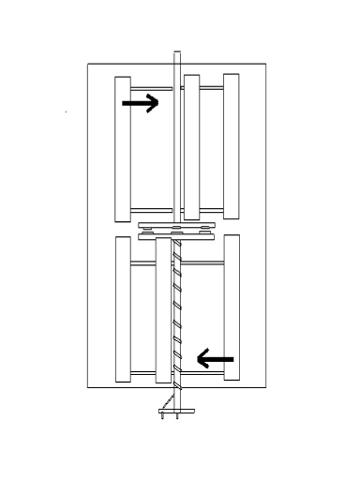

Hi Gill "Some thoughts"
Any thoughts to putting the stator in the middle of the mill?
Could there be turbulants from the two differant directions?
If the slip plates could be enclosed from the elements would they last better?
THE Pirate.

I like the Idea, but I have had bad experiences with slip rings. The company I work for makes composite deck boards and we use slip rings for the embossers. The line only runs 14 feet per minute and if the slip ring comes loose, lets just say it is a maintenance nightmare. I cant imagine what would happen at higher speeds. If there was a way the make the wires accessible and easy to maintain, I would be all for it.

AC synchronous motors have slip rings on the rotor to allow the [wound rotor] current to be altered so the power factor can be improved. These motors can operate at 1500 RPM. The bonding of the slip rings is only an engineering issue. It can be done. The slip rings and brushes should also, be protected from the weather.

I think most VAWTS could use this system. Balancing would have to be of the shaft and all attachments (includes stator). Securely attaching rectifier is not such a drama if fitted with mounting hole or stud.

Stator in the middle mentioned already. With the torque of these VAWTS, why not fit one in middle and on the bottom of the same mill? Ideal for Glen's dual staggered winding giving early cut-in as well as a high speed generation?
I can't see any great turbulence issues. Certainly none in the order of counter rotating propellers or helicopter rotors. That's why I don't see this as having any potential with HAWTS.
Any weather protection will improve rely ability, but there are limiting factors(none of my mills will run in the shed. ha.ha.)

Many proven techniques (slip rings) can be porly designed or manufactured when utilised in specific equipment. As Gordon advised, it is a standard method on much higher rpm motors than we run VAWTS at. There is nothing wrong with the idea when it is correctly made.
All vehicle starter motors run heavy brushes on to a commutator and a commutator with its gaps and arcing is much more severe than any smooth slip ring.
All,
There's likely 100's of ways to build a VAWT incorporating this counter-rotating idea. The engineering is just a little more involved than the beginner builder might handle, but the improved speed for power generation with such a minimal loss of torque has got to be a worth while project. Indeed the slight frictional loss from torque will be more than compensated for by a cut-in at 1/2 the former wind speed due to the 2 x higher gen rpm.
I like it!
