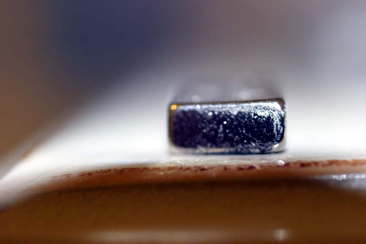

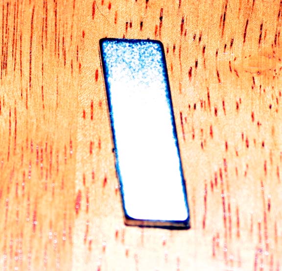

I just got my magnets. They are slanted to reduce cogging and they are curved to exactly fit the curvatur of the F&P rotor. There is no clicking or bad seating; it is perfect. I am hoping the tight fit adds to the strength of the rotor so there is no warpage.
Here are some pictures. It is subtle, but note how the second picture slightly curves up on the righthand side off of the table. There is an arc incorporated into the magnet design.

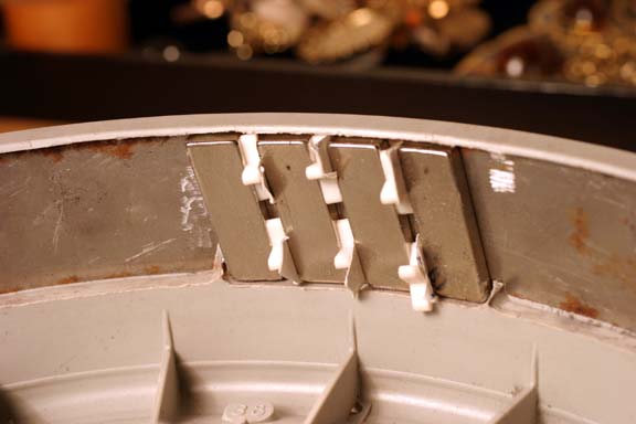

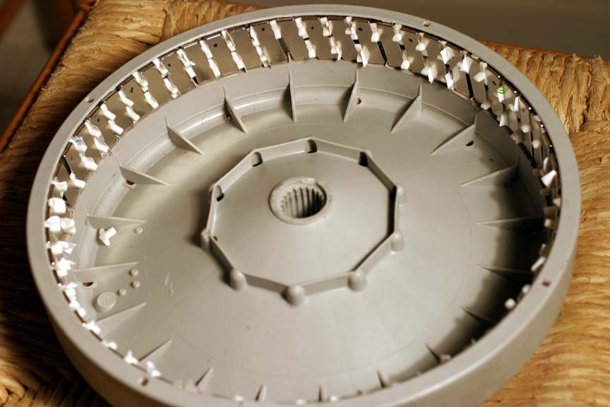

Here are my updates so far...
Starting the process using 3mm tile spacers plus two sheets of paper per spacing.
Rotor ready for fiberglass sealing

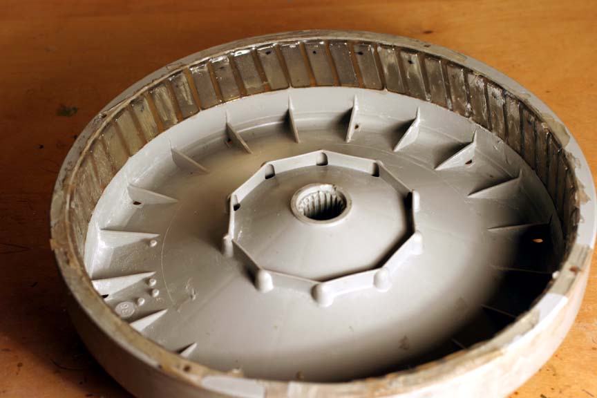

Well, here is the update. I sealed the rotor as follows. I put lamination paper around the outside of the hub and fixed with tape. I removed the spacers and spilled some resin into the gaps, letting it cover the magnets up to the inner lip. I let it set and rotated the rotor and poured in more resin. I repeated this process of pouring, setting, and rotating until I finished th whole rotor. This took a day. I had tried using various tapes on the inside, but the surface wasn't smooth and I couldn't tell if I was making too thick of a coating. I used a file to shave off fiberglass resin where it was too thick. Here is the picture.
Now, I loaded it onto the stator hoping it wouldn't warp. The end result - absolutely no warpage. As I hoped, the perfect fit of the magnets reinforces the strength of the rotor. Also, the thickness gives a little more distance from the iron core, reducing the pull. Using formulas, I calculated the the pull in pounds for the ceramic magnets is 0.6lbs; the pull-force of the neos is 6.83lbs. We have an x11 difference in pull. However, despite the added force, the rotor kept its shape with no special effort on my part!
