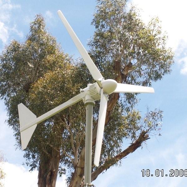

Hi, has any one played with one of these chinese wind gens. I've purchased one off ebay to see what they like. It seems to spin very slow for the quoted 24 volt charging ( manual says 400 rpm) yet the blade pitch is very shallow. When I run the machine into a 48 volt load, it appears to be a lot better ( starting up, charging at lower speeds, spins more consistanly with the wind speed etc)

it probably works better at 48v becouse it dosnt see the load until it reatches the load voltage.
when connected to 24v batteries load it will load quickly and therefor stall the gen.
my neighbour has a similar unit from china only worked for a short while then the controler stopped working. the mill seems fine but.
the blades look ok, are they pvc?
the neighbours are pvc and do work quite well
the gens seem to be ok although i have read in this site someware the bearings can fail or slip easly probably worth replacing with fully sealed quality ones and locktight into place.
i havnt stripped on apart but you could probably mod the unit with stronger magnets also keep away from trees and wind obstacles as much as possable

The blades are fibreglass coated timber. I've resanded them, taking the rough casting edges off and repainted them.
The bearings have already been replaced also as part of some the work done on the machine after reading elsewhere that they fail early.
The gen only in the test position before it goes into its final higher location. Its easier at the moment get it up and down for adjustments, testing etc. as the final location is going to most likely be 60' in the air. (if the unit comes upto scratch)
Currently using a Tristar TS60 shumt regulator and a 3 phase diode bridge after testing the orginal supplied regulator and found it to be very ordinary in performce and also seeing some of your members also discarding it.
One of the tests that I done was to measure the OC DC voltage in about 5ms of wind and it measured at 120 volts.
You probally right about the magnets. When I had the gen apart for the bearings, the magnets didn't appear to be any of these good neo's etc, they looked to me is if they are ceramic or similar ?
IF anyone any info or thoughs on these units, please post a reply.
