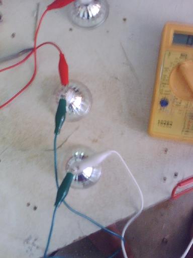

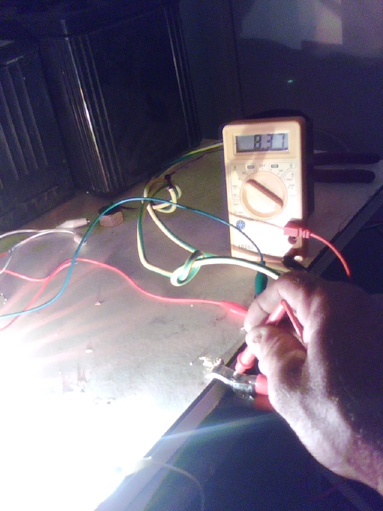

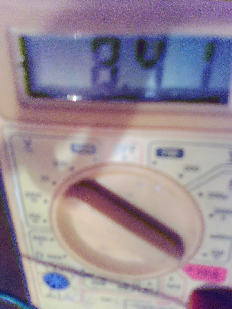

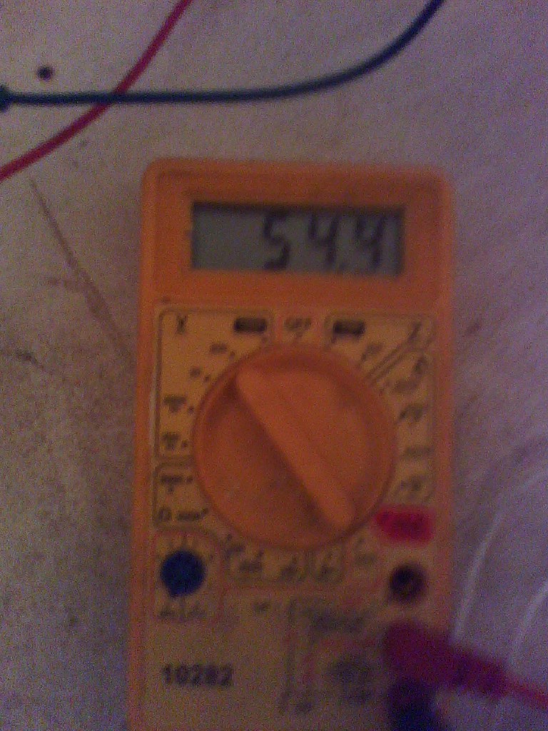

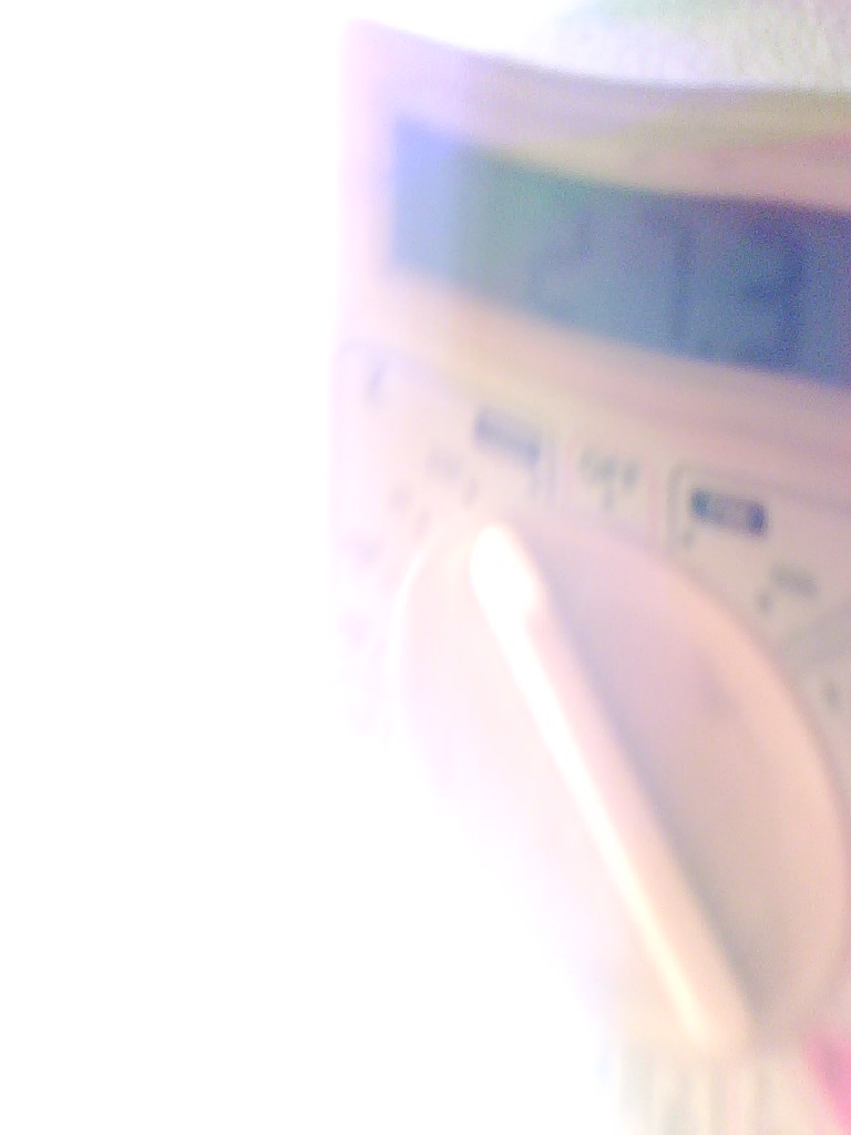

well I have been testing my units in the lathe as discussed, I am testing the 7p2p and 7p3p 7 phase with new rotor. firstly I found that I had a great deal of belt slippage on lathe when generator was loaded, I put on a new drive belt for the lathe and started testing.
First test is the 7p2p. The o/c is 54 to 55 vdc. I then loaded with 4off, 12v*50w spotlights wireing 2 together in series for 24v at 50w, then both sets wired together in parallel, should be a load of 24v at 100watts i believe and reduce o/c to about half. I got 8.41 amps and 27.3 volts on multimeters. Lathe is set at 480rpm but slows down to about half that when loaded. Both generators im testing are 80 series 7 phase using new rotor.
gill could you please suply me with the calculations for correct rpm. and how do i test for frequency?
hope this is better info.
the test unit a 7p2p on lathe
o/c at 54.3v
volts
amps
seems lots of power
slowed down to about half speed
8.37 amps
the 7p2p i am testing seems to charge mt 24v batteries quite well in this enviroment,
i will hook up the 7p3p tomorro and report back my findings
thanks heaps
martin
free power for all
McAlinden WA

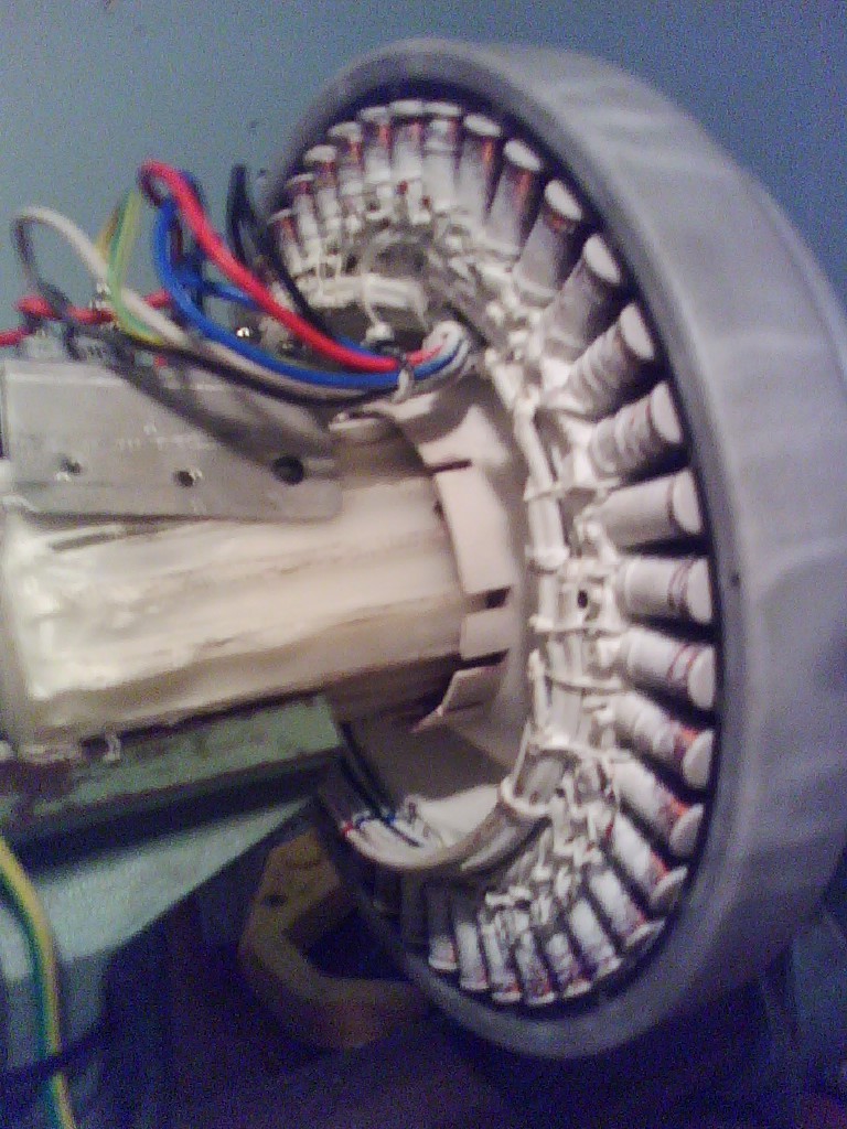

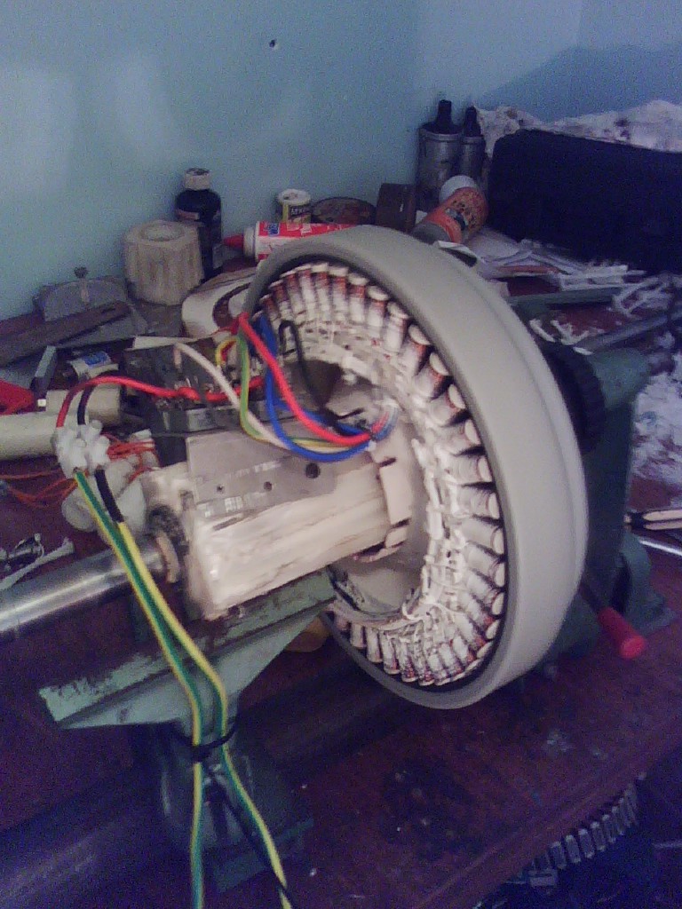

i have started to test the 7p3p today and got some interesting results.
lathe setup
7p3p oc volts
7p3p loaded volts
7p3p loaded amps
7p3p load setup

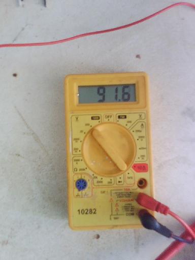

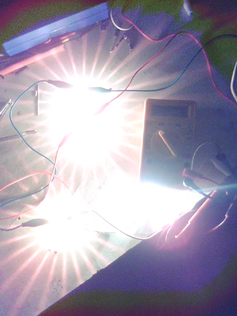

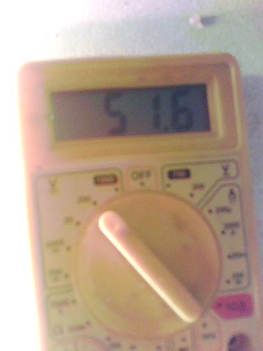

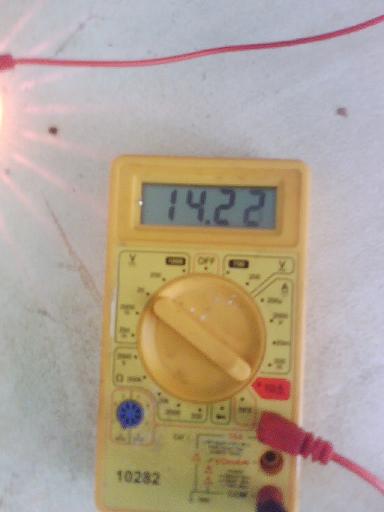

the o/c is 91.6v
on a load of 3*12v 50w downlights wired in series
amps on multimeter was 14.22 amps
volts on multimeter whilst loaded is 51.6
this gives a source resistance of 3.63ohms
form there the power max should be 2236.55
am i correct with my calculations, if this is watts then theoretically these can produce 2kw?
martin
free power for all
McAlinden WA

Ummm, I think something is wrong (or maybe I dont understand)
14.2 amps through the lamps in series is surely not right? With lamps in series the current they could handle would be the same as a single lamp, i.e. about 4.2 amps.
GWatPE
Joined: 01/09/2006
Posts: 2127
Posted: 11:55pm 29 Jan 2008
Hi Martin,
The 12V bulbs give 50W consumption when connected to a DC supply of 12V. You are not supplying a pure DC supply as indicated by the 3 bulbs in series across an indicated 51.6V. Your multimeters are not able to show the RMS volts or amps. If the readings were true then one of the light bulbs would fail. A good indication of your meter reading incorrectly are the clip leads. The ones you are using are rated for about 4A.
Ohms law, V = I x R
I = V / R
and Power = V x I
= I x I x R
= V x V / R
The link http://www.tina.com/course/11maxim/maxim.htm
is not clear in the formula with placement of operators.
You will probably find like others that at the RPM you are testing that you will be producing 150-200W as indicated by the light bulbs.
Don't despair too much by the readings indicated by your meters. The meters are OK for pure DC or pure sinewave AC. A rectified generator output is neither.
Good luck with future testing.
Gordon.
