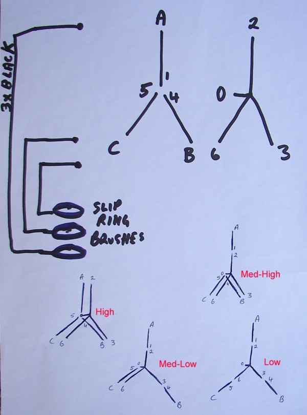

It took me a bit to work out because of the odd numbering.
It obviously works in spite the imbalance.
I wonder how good that system is and are there any inherent week spots?
What's more, how do I apply this to 7 Phase???????????
This pic for those to full of Christmas cheer to work it out.

Hmmm, I guess there is nothing actually wrong with adding out of phase windings. In fact it might actually be a very cunning plan, so cunning you could pin a tail on it, so to say.
Adding windings that are out of phase would give a voltage increase somewhat less than twice, 33% maybe?
So, ummm, maybe:
High= 2
Med-High 1.66
Med-Low =1.33
Low=1
I am trying to imagine if 'inbalance' is significant, somehow I dont think so. It looks like a valid technique to me.

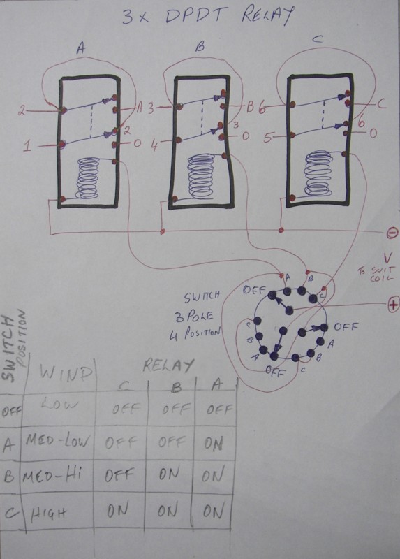

What's more with Star/Delta you need 2 x relays for switching and you get 2 configurations.
With this one you need 3 relays and get 4 configurations.
More gooderer.
For anyone with a test rig and keen to do some testing, here's additional circuitry for manual switching between the 4 modes.
Not so hard really. Could all be done on one stator.
Edited by Gill 2007-12-23

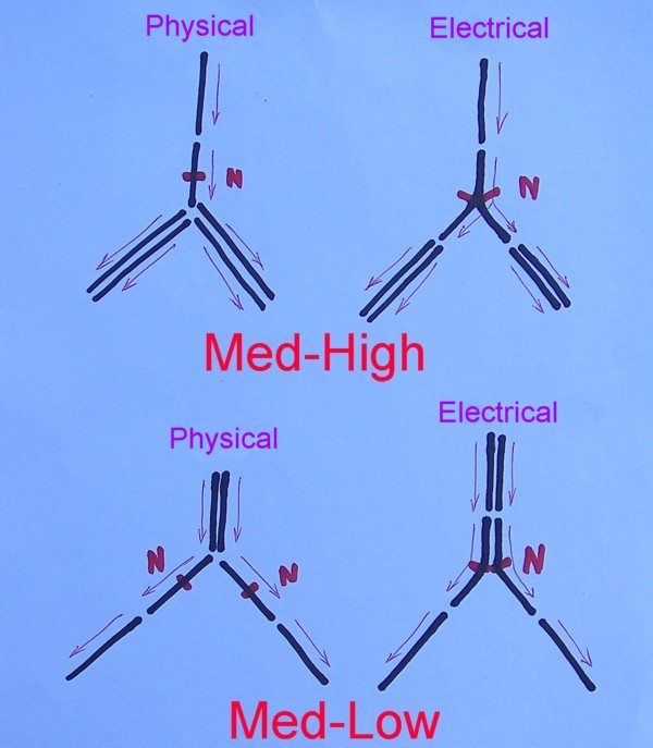

I can now assert with confidence the system is indeed balanced in all it's configurations in spite it's physical appearance.
Like a triangle where a circle can always pass through each point or a three legged table can never rock, any 3 phase configuration will always be in balance.
A technique is used on radio antenna where wires are split or combined(G5RV,Zep,Bazooka to name a few)to achieve physical relationships for construction that seem less than ideal yet with respect to their currents they are fine.
Using the first Physical sketch, take a razor and split the wire lengthwise from the bottom up to the Neutral mark.
Now pull the two legs and apart and you have the true electrical arrangement.
See voltages are indeed balanced.
I have also drawn the currents as relating to each coil and this confirms the balance.
Conversely, for the lower Physical sketch, pull in on the two Neutral points till they touch and you have the end sketch of the true electrical arrangement.
You could solder these points together without effecting anything but only in this configuration.
I for one will not hesitate using this principal with confidence as soon as circumstances allow.
