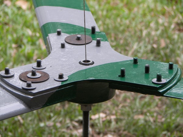

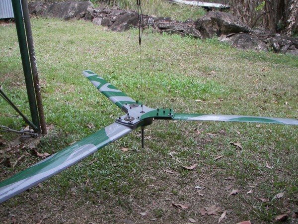

I have found this method most satisfactory. It gives a high degree of accuracy for the static balancing of a prop.
Here is an action shot with no movement evident.
With this method the prop is a beam balance and the string entry to the plug is the fulcrum.

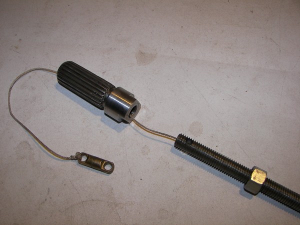

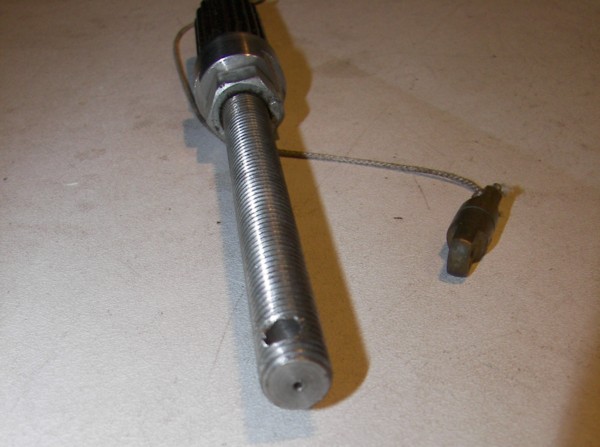

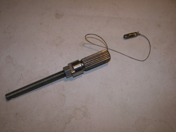

Here is the stub off an F&P shaft I made to plug the hole and provide a fulcrum with a centre of gravity adjustment.

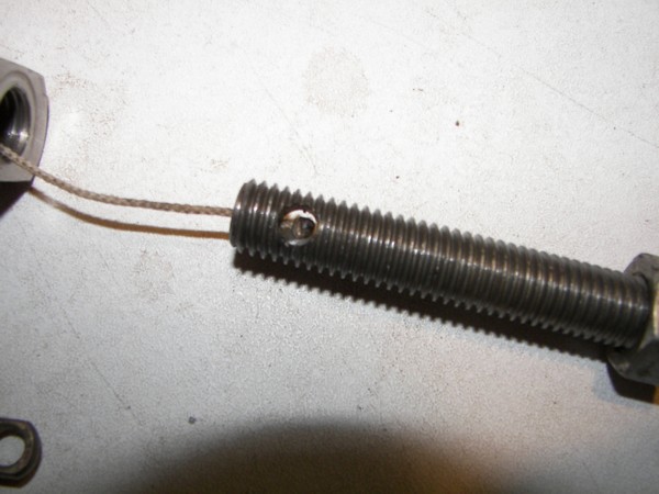

The main thing to note if you make your own, is that for consistency, the thread must be firm and the string must be tight through the string hole.
string hole (I have two. one each end for different size strings)
knot hole
Method:
Pick a dead calm day or go indoors where no draughts.
Fit the plug to the prop.
Lower the C of G (centre of gravity) for a dead action.
Add weight for a horizontal balance.
Raise the C of G and adjust with weight as required.
Repeat this step until a very sensitive action is achieved.
Never fear, most will go to far to a neutral or accelerating action and get odd and confusing readings. Just go back a little.
Well that's how I do mine. Hope you have fun.

Hi Gill,
Let me see if I got that
1. what you call the 'fulcrum' is the top end of the threaded rod, where the string exits?
2. the balancing 'action' positions are adjusted by screwing the threaded rod in and out (up or down actually) on the splined stub?
3. your propellor hangs backside up and the washers (or lack of them) are your balancing weights?
Did I get it?
Very clever, your method that is.

Tinker,
Your spot on working out what I didn't say. It's a YES to each question though the backside facing upward is because the CofG is closer to that face on this prop.
If the blades protruded forward and the C of G was to be near or even further forward than the front of the hub, then that face would need to be uppermost. In such cases the threaded rod can protrude past the splined stub to position the fulcrum in correct relation to the C of G even if the C of G appears to be in no-mans-land.
Cheers Gill _Cairns, FNQ
