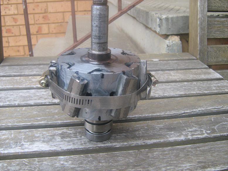

hi dwyer i will attempt to put some pictures on here of my generator as i made it. but my computer skills are not the best i hope they turn out.one pictur of the rotor after i had welded and machined and had put magnets on. The magnets had to be put on a angle to stop cogging as i found out the hard way after 2 attempts.the magnets in this picture are only the north magnets. It has very little cogging now if any with 2 meter diameter blades and it spins up really easy. The other picture is of the generator with the alternator complete.
Hey I just moved the pic down to narrow the post up a bit, hope you dont mind. Glenn.Edited by Gizmo 2007-12-19
