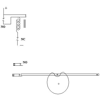

There have been a number of references to switching star to delta between high and low windmill RPM.
Probably the best way to do this would be with an electronic circuit monitoring the frequency of the alternator output but for those who would like a mechanical way of doing it I present this simple scheme:
There is a simple cam on the alternator shaft and bar, pivoted at the right hand end moves up and down as a pin follows the shape of the cam.
The moving end of the bar actuates two contacts, one normally open and one normally closed.
At low RPM the pin stays in contact with the cam and at the bottom of the stroke it touches and opens the normally closed contacts. At higher RPM the bar begins to 'float' and the pin loses contact with the cam and the bar no longer opens these contacts. At some point as the RPM increases the bar will float high enough to close the normally open contacts and when it does the relay will pull in and be latched by its own contacts.
The relay will stay closed until RPM drops and the bar again contacts and opens the normally closed contacts and so unlatches the relay.
Thats the general idea!

KiwiJohn
Joined: 01/12/2005
Posts: 691
Posted: 06:59pm 10 Dec 2007
Ha ha, I knew there would be something wrong with it! Funny thing though the same principle seemed to work for about 100 years dinging the bell on the old cream seperator! The mechanical side of my brain tell me that if I wanted it to last forever I could put a small ball race on the pin!
The practical side of my brain tells me the switch from an induction motor does nothing except operate once at starting and would be rather difficult to incorporate.

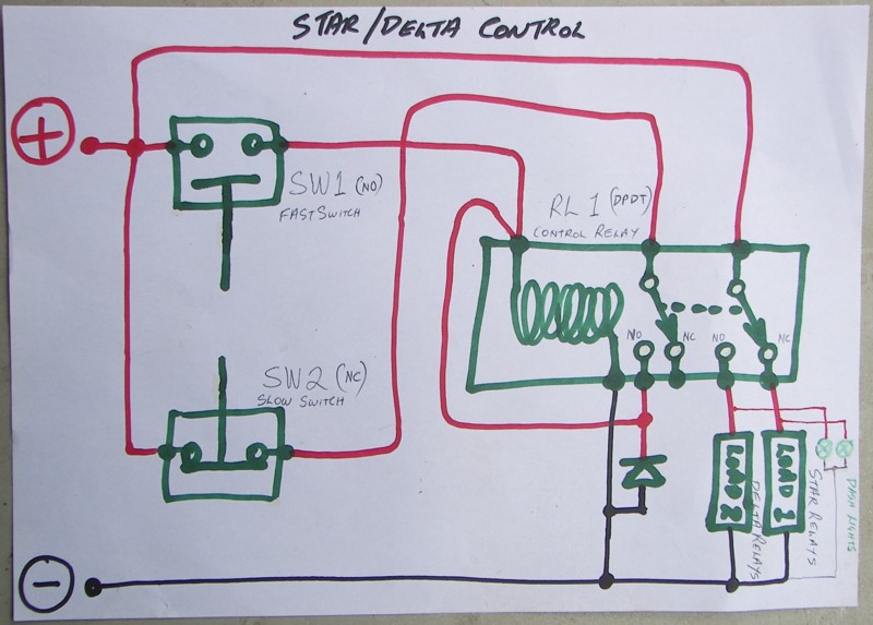

A workable mechanical approach to Star/Delta switching there John.
Your circuit is a bit vague though, so here's my vague circuit too.
Am considering whether to retro fit one of these to GillMill_1 ........ But So Many Projects on the GO!!!???
Cheers Gill _Cairns, FNQ

You schematic is so much nicer than mine Gill, did you draw and scan that?
I have been thinking about this mecahism and I think the shape of the cam I showed is way more than is necessary, in fact I suspect just a circular cam with an off centre axis would be sufficient and the switches could be micro switches mounted on a backing plate.Edited by KiwiJohn 2007-12-16
Gill
Joined: 11/11/2006
Posts: 669
Posted: 08:15am 15 Dec 2007
Yes John, my thoughts were to use micro switches too.
Many versions of cam idea, in fact, need not be a cam but a grooved track would work as well with the lever pivoting forward and back instead of up and down.
So long as there is still the motorbike jump effect off the cam ramp at higher speeds.
Scanner is dead like the printer so sketch and photograph page is the work-around. So much faster than graphics programmes to get a simple ideas across.
