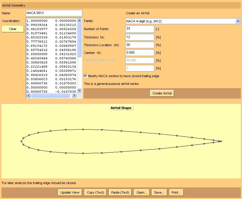

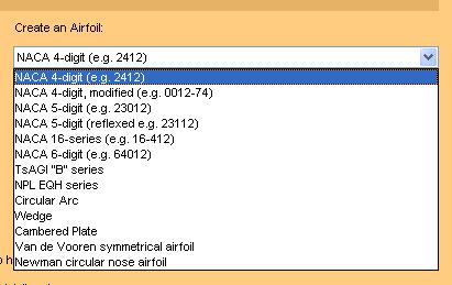

Hi grassfu,
Here you can find a program (you need Java installed on your computer, not javascript) for airfoils.
It have only few profiles but you can design your own, and simulate airflow...
You can modify resulted airfoil and hit "Create airfoil" button again.
Then you can import coordinates in Rhino. Mr. Bean have a tutorial on his site.
Or wait for Glenn tutorials on his CNC site.Edited by vasi 2007-12-17
