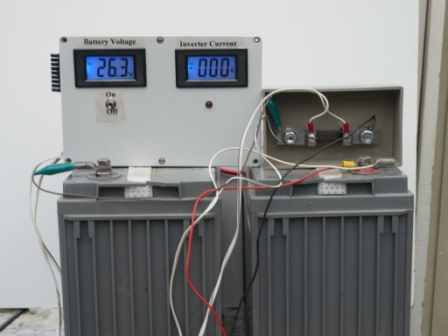

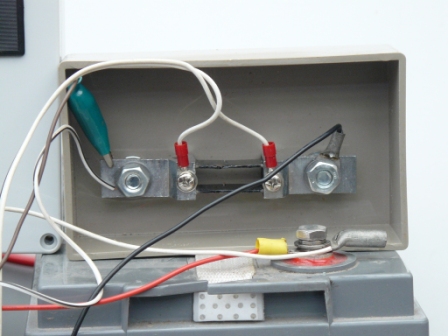

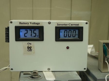

Here are some photo's of the test setup of the monitoring panel and the current shunt.
This test setup is with two 12 volt batteries, but the volt meter can measure 199.9 volt.
The amp meter can read 199.9 amp.
The current shunt is 200 amp 75 Mili volt.
The volt mater, amp meter and the current shunt were bought on E-Bay from Hong Kong and China at very competitive prices.
I also had to buy a couple of small DC-DC converters that have an isolated output,as the LCD meters require a power supply that is isolated from the measuring circuit.
These DC-DC converters were about A$ 15 each including postage, it all took about 15 days to arrive.
The small heatsink on the lefthand side of the monitor box is for a voltage regulator to drop the voltage from 48 volt to 24 volt, as the isolated DC-DC converters that I bought were for 16-30 volt input ( they were originally bought for the 24 volt system that we had) and I had the regulator in my box of bits, as I did not want to buy another set of regulators.
The volt meter and amp meter information is as followes:
3 1/2 Blue LCD Digital Volt Panel Meter DC 0-200V
3 1/2 Blue LCD Digital Amp Panel Meter DC 0-200Amp
The following is the information for a 10-16 volt
DC-DC Converter Isolated Power Supply
Input 10V-16V Output 12V
Input: 10V~16V DC
Output: 12V DC
Power: 1Watt (max)
Max isolation voltage: 1000VAC
The web address is: http://stores.ebay.com.au/Asia-Engineer
All the wiring to the monitoring box is low current the volt and amp meters draw less than 50 miliamp and therefore do not put a drain on the batteries.
When I get back up the bush I will take photo's of the complete installation and post them here.
Edited by ericvr 2007-11-29

Looking good,
that meter box looks very professional
