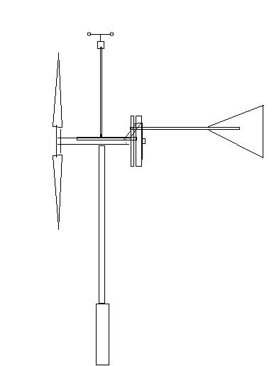

what I had in mind was a pole sticking up above the rotor disk with the anemometer on there.

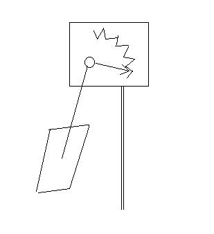

The second diagram is of course the very simple vane and potentiometer anemometer. If it is not mounted on the mill it would of course need its own directional vane to keep it into wind.

the left diag would require a hollow shaft for the yaw box if I am not mistaken.
I am sure the vane would have a very non linear response.
