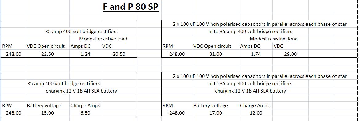

I had read with interest other posts on this subject so decided to try a similar configuration. I have used 2 100uF 100 volt non polarised capacitors in parallel across each pahse on a F&P 80SP. From your post I would say I have gone too big for the caps. But I did notice a votage increase and also a current increase. The attached image provides some details of the results.

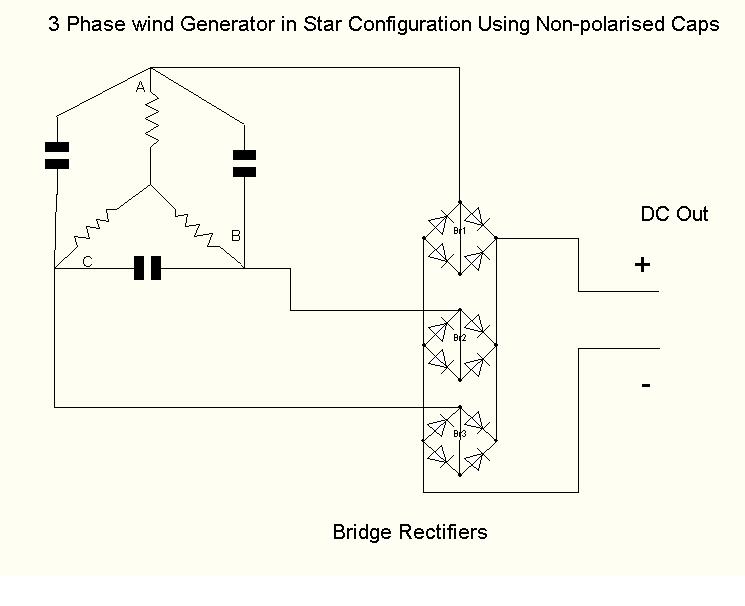

Heres the schematic of the way to hookup the caps.
Cheers Bryan

Thank you Bryan for your Schematic
The three non polorized caps we use are between 50MFD at 400 VDC and 145 MFD at 240 VDC. It appears the higher voltage affects the way they operate or perhaps its there large size. The 145 MFD seems to work a little better than the 50 MFD . MFD is the same as uf You will double your output on a 80SP in Star with capaciters. This a 100% guarantee with $100 being available to anyone who proves it wrong.
There are many other ways of wiring caps in but the above schematic shows the best method. I have now put my money where my mouth is so give it a try. Our 5 blade Piggott easily turns 6 Amps at 26.2 Volts into 12 amps at 27.5 We continually have to use our dump load . That is in a moderate wind Regards Dennis L

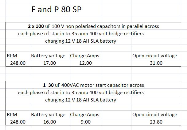

I first tried 2 100uF non polarised capacitors in parallel (total of 200 uF) across each phase and was impressed with the results.
But I then put a meter set on AC current in series with one of the capacitors (2 x 100 uf) and was surprised with a reading of 5.8 AC amps. I think that current at this level could cause over heating of the capacitors such as the cross over capacitors that I have used.
So I then tried 30uF 400VAC motor start capacitors across each phase and the AC current was measured as .7 AC amps which is a significant drop. But unfortunately there was also a drop in output volatage and current. See attached image for a comparison.
p.s. I only charged the battery for a few seconds to get the voltage and current readings.

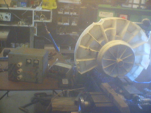

Glen My lathe is all set up with variable speed drive (electric drill and variac ) And can support a smart drive in chuck I then stop the stator turning with balance measuring torgue speed is measured by hand tacho also I store output on stoage scope as I take measurements to check speed. I feed out put into my shed battery bank that is also suppling the Lathe so battery volts stays resonably constant also a small hydro and windmill is feeding in to make up losses. I have found it is necessary to test into a battery as resistive loads use all waveform, batteries only use peaks . along with capacitor tests I see its about time we got a relationship of number turns producing to output along with current limits when stator flux cancels out rotor flux about 240 ampere turns I believe.
