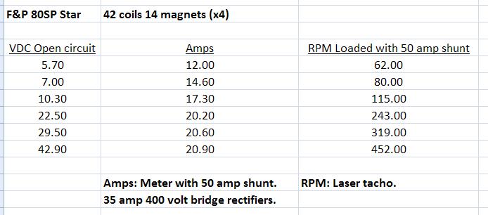

Hi Folks,
I have attached (I hope) an image that lists current details and associated RPMs for an 80SP. The max current plateaus at about 20 amps and my question is if 20 amps is the maximum that can be expected from a standard 80SP.
Thanks,
9c12m

please check
http://www.ecoinnovation.co.nz/pdf/smartdrive_what_is_it.pdf page 14.
the output power v rpm has already been done, and is published here.
hope this helps!!

I wouldn't trust those tables on eco inn.
I'de be more inclined to use them for ass paper.
