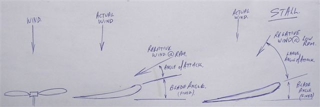

Regarding improved efficiency through various means...
I expect there is an optimum angle for the wind relative to the turbine blade and whenever this angle is not optimum the turbine is either under or over loaded.
Now having thought of this I dont have a clue about how this theory can be practically used.
One idea may be to design a variable pitch system where the pitch is changed automatically in response to relative wind angle.

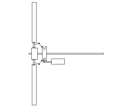

With MPPT's or multi coil turn stators or phase switching all these techniques can only improve the conversion of shaft power to electrical power. Sure these approaches greatly improve the electrical efficiency over the range of RPM which equates to varying wind velocity, it does not however address the inefficiencies of fixed props converting wind power to shaft power over the range of speeds usable for power generation.
In the past many attempts have been made to adjust the prop to maintain the correct angle of attack at any speed. The usual method is to employ centrifugal force(increases with RPM) as the force to move and the control indicator. Many mechanisms have been invented but the lack of any in common use is indicative of their high cost and/or ineffectiveness.
Perhaps with the electrical boffins working hard on creating higher electrical efficiencies it is appropriate for the mechanical fraternity to challenge itself with the creation of what is primarily a mechanical system????
Unfortunately I lack the resources to create and make my own ideas in steel. So here is a sketch of what I would do if I had the resources. Perhaps it will inspire someone with mechanical ability to come up with something "that works".
As you can see I've departed from the centrifugal force method to an electrical/electronic one.(stepping outside the everyone's done it box) The electrical control is not the problem, it is the mechanism.
Yes it does consume the valuable energy that we are trying to create, thats a minus. But on the positive side, besides controlling the angle of attack over the entire power range, it also controls the prop outside that range. It maximizes start up torque by setting the best angle, it feathers the prop when the prop over speeds and it can also brake the prop should an emergency arise. So no more need for furling tails. And all this can be controlled and adjusted from the ground. "I want one".
Well thats my idea.
Anyone else got any?
And as important.... can you build it???Edited by Gill 2007-10-17

Gordon, sorry I did not express my idea very well. I am of course thinking of wind angle relative to the blade, not the entire rotor disk. However you did touch on something else and that is the lag involved in aligning the rotor as wind direction varies, another possible area of improvement maybe?
Gill, the variable pitch mechanism on some helicopter tail rotors is quite simple(and not really unlike your drawing) though there is just a push rod and a thrust bearing where you have the motor and threaded assembly.

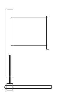

Meanwhile I have been trying to think of something more simple:
In this picture the shaft is at the bottom and one blade is mounted so that it can freely swivel around the 'spoke' that we see extending upwards from the hub. Over to the right is a trim tab mounted on extension arms to get adequate leverage.
The blade is pivoted as near as possible to its centre of pressure, though that may move a bit.
The idea is that in a light wind condition the trim tab will be blown back and the blades will be in fully fine position. As the rotor begins to turn the wind relative to the trim tabs will change and so will the pitch of the main blade, becoming more coarse as RPM increases.
Now I just need to figure out if this is what we want to happen under various conditions.

John, there certainly are correct curvatures and angles, but unfortunately these change along the length of the blade and for different wind speeds.
To gain a bit more insight, try sniffing out some information on sailing, and learn how a yacht sets and trims it's sails. Other sources of information are available from the basic aircraft principles of lift and drag.
Another application might be the blade design of impulse steam turbines in some thermodynamics books, if you are really that interested. The internet is your friend.
What you might need to do is build a wind tunnel and test some scale models of various blade designs. That may not be as impractical as you think.

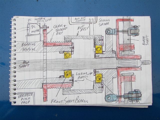

Meanwhile, here is my concept for the most simple variable prop system, I trust the diagram is self explanatory. Uses a clutch thrust bearing etc.
Warpspeed
Joined: 09/08/2007
Posts: 4406
Posted: 09:03pm 16 Oct 2007
I like the clutch bearing idea John. Helicopter blades are controlled in a fairly similar way to this.

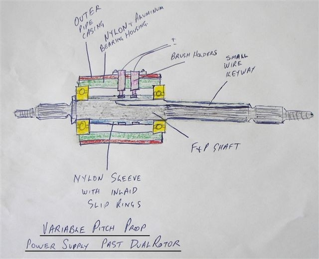

Gill
Joined: 11/11/2006
Posts: 669
Posted: 01:58am 17 Oct 2007
I've sorted the problem.
"Where there's a Gill there's a Way"
The way past both spinning rotors is not via a hole down the guts but via a keyway down the outside of the shaft.
It need not even be machined. A cut off disc in the right hands could make it.
I think I can retro fit this to my mill in progress.
Now to source the bitz.
Cheers Gill _Cairns, FNQ

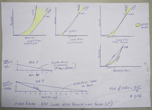

The following is blade theory leading to variable pitch AS I UNDERSTAND IT.
We know wind power is velocity^3 and that generator loading is linear (to a point). We do not need to get into detail provided understanding is maintained.
The 3 top sketches represent common conditions of fixed blade DIY mills.
On the first gen loading is less than power available oft times the owner blissfully ignorant of the wasted power...hay it works fine!
On the second wind power falls short of meeting gen loading. This causes the prop to slow(or not increase speed with increased wind speed) the blades stall usually around 1/3 max expected rpm. The owner curses.
On the third the wind power and gen loading are maximised. There is however large amount of wasted wind power at the higher velocities(fixed pitch & single coil configuration).
With the fourth diagram of that series I see the wind power matching the max gen loading. On a fixed pitch prop that would cause stall at lower rpm. But by varying the pitch to the TSR the blade does not stall with it's resultant loss of lift. When the blade angle changes to match the TSR the Angle of Attack does not increase to stall angle. The Tip Speed is not held linear to wind velocity but adjusts itself to the power available.
From memory
Typical AofA for stall = 16deg
Typical max lift AofA = 12deg
Typical design AofA = 3 - 5deg
I think the stall indicators would be more for warning of pilot error than as efficient flight indicators. I think there may be better ways to indicate pitch adjustment on a wind mill, still I guess it's possible. Edited by Gill 2007-10-18

Gill, thank you for you diagrams etc.
What I am trying to say can be described in the last diagram. In your very last figure you show a blade in stall, it has stalled because either the mill is overloaded and the blade cant turn to make full use of the wind or the wind has suddenly increased, for whatever reason the relative wind vector has moved to cause excessive angle of attack. The blade has stalled and the airflow over the blade is not smooth as we would like it to be causing the low pressure area at the back of the blade to spread out and move nearer to the leading edge which is what the various stall warning sensors would detect.
The blade has stalled because the pitch is too fine for the conditions of load, RPM and wind speed. The blade needs to be moved to a coarser pitch, i.e. move it closer to the relative wind, the RPM will then come up, with the relative wind (and hence angle of attack) moved the blade will be 'flying' again at which point the pitch can be fined a little to extract more power.
So the thing to do in this instance would be to reduce the angle of attack by altering the pitch by twisting the blade in a anti clockwise direction (in your diagram). Do you think this is the right thing to do?
My opening post showed the idea of mounting a moment arm and a vane on each blade to move the blade so as to track optimum angle of attack according to relative wind. No doubt there are more elegant ways involving, for example, some means of detecting relative wind and power driven change of pitch mechanisms, or maybe the moment arm and vane could be used.
I am not batting for the moment arm and vane, what I am doing is trying to stimulate discussion on the importance of angle of attack and ways to detect it make use of the knowledge.
