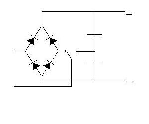

Here is a simple circuit that will double your voltage (or halve your current) with just a single relay change over.
The AC from the alternator comes in from the left and with the relay contact to the left (as shown in the diagram) we have 'normal' full wave rectification for charging our battery via the two connection on the right.
Switch the relay contact to the right however and the circuit converts to half wave, voltage doubling rectification. One half cycle charges one of the capacitors and the other half cycle charges the other. The total voltage of the two capacitors is available to charge our battery.
I suggest the way to use this would be to configure our F&P for a low voltage by putting more coils in parallel. This will decrease series resistance and increase the available current but the voltage at low generator RPM may be too low to charge the battery, that is when to use voltage doubling mode.
When the wind picks up the circuit is switched to 'normal' mode to avoid excessive voltage.
I think the circuit could be made fully automatic by wiring the relay coil across the AC input with necessary series resistance to cause the relay to switch at the desired voltage level.

Yea this is as you say a well known cct used extensively in pc supplies to change 230 v to 110 v input.
It could be used in FP need one per phase parallel outputs a simple switch/relay will double volts for low volts
another simple technic use three indepentant for low volts then short one AC side bridges to change star only needs two normally open contacts.
