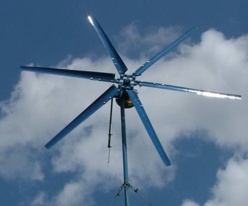

I made a set of PVC blades on the weekend, there's an entry in my diary here http://www.thebackshed.com/Windmill/FORUM1/forum_posts.asp?T ID=744&PN=1 where I start work on a dual stator windmill and needed a big turbine to drive it.

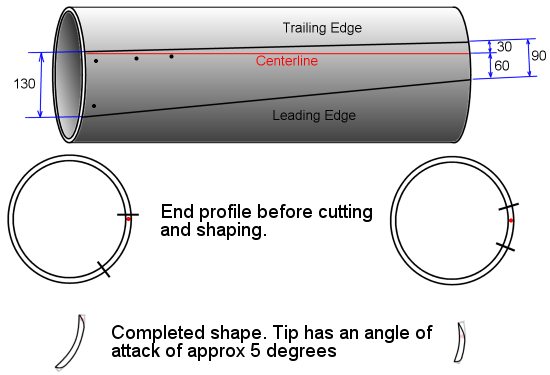

The new blades have been up for a couple of days now and they are working very well, so I thought I would post the plans here in case anyone else wanted to make a set.
The 6 blades were cut from a 1100mm length of PVC pipe, 250mm diameter. To give some twist and keep a wide chord width at the tips, I offset the trailing edge by 30mm along the length of the blade. The wider chord means a stronger blade, hopefully, and more low speed torque.
There is no real maths in this, I just drew up what I thought would work with the length of PVC I had. The result is a quiet set of blades ( even when free wheeling! ), with lots of low speed power.

Glen I think the drawing for the blade cutouts is wrong some how.
I was looking closly and getting ready to cut some blades but from looking at your finished product compared to the cut out templete it seems wrong, or it could just be me.
Your finished blades in the picture could be described as Root of the blade to the left, Tip to the right. 3 Bolt holes lined up on the trailing edge with the concave surface facing up, when lying on the ground.
The result from your marking and cutting from the picture would have the Concave facing down.
Is it me, just being dumb or is there a problem somewhere.

Now that's attention to detail! You are correct!!
Not that it'll worry you - it'll just spin the other way, and you'd have to reverse the angled brace piece!
The three bolt holes in a line are closest to the (almost) right angled corner of the blade.
With concave face up, root towards you, and tip furthest away, the cutting diagram would have the three bolt holes on the right hand side of the blade, and cause rotation in an Anti-clockwise direction.
Whereas, Glenn's actual blades have the three holes on the left (root close, tip away, concave up), and rotate clockwise!
Here's a trick though! And it'll save Glenn re-drawing the diagram!
It'll involve a little concentration, but imagine the front of the tube is transparent, and you're looking at the INSIDE WALL of the BACK OF THE TUBE!!
It might take a bit of effort, but you can do it.
Then, the three bolt holes ARE on the left(root close, tip away, concave up), and rotation once again is clockwise!

I thought that was the problem and the result, but did not want to start cutting till I had some back up. Thank you very much for the support.
The transparent tube idea works for me but I think it works just as well if I follow all the measurements and work from Right to Left. Ie the Root of the blade will be on the right hand side of Glens drawing.

Posts: 5200
Posted: 08:49am 18 Oct 2007
Yes you are spot on, it is reversed. I remember I planed to cut them that way, but I had a moment and worked out the turbine would spin the opposite way to the near by southern cross windmill. Now anyone who has had two windmills near each other that spin in opposite directions will tell you how silly it looks, almost annoying to look at. So I changed mine to spin the same way as the 'cross.

Hi, yesterday I build the blades you described in your thread. I have some questions:
- could it be, that the drawings on the tube are mirrored?
- when I now see my blades I would say they will turn counterclockwise. If so, is it a problem? Should I build the blades new?
Thank you for your attention.
