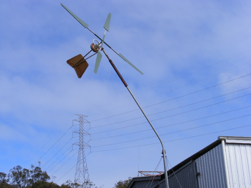

Well Murphy is really giving me a hard time with wind gennies. First I got hardly any wind and when the genny did turn the best I saw was 6 volts so I've defenately stuffed up the re-wire somehow. Anyway Murphy came with a venegance on thursday night as the pic's show. My tower was made from 2" thick wall water pipe as per Glenn's tilting tower. I must admit I should of put guy wires on the top section but I never though murhpy would come around and bend that pipe like it was a pipe cleaner.

Wow!
Well at least it proves the the blades were working well, she must have been going fast when that happened. And it means your guy wire anchors worked too.
My top guy wires are attached to the tower just below the bottom edge of the blade diameter. The 2nd set of wires attach at the pivot point like yours do. Been a tilt tower, yeah it means I need to disconnect two of the top guy wires before I can tilt over the tower, but the bottom guy wire are strong enough to take the load so long as the wind is light.
Nice looking windmill.

This guy, Murphy, is very strong. Next time watch him carefully. Anyway, he needs medical help ... don't let him alone.
Yes, the propeller resisted!
