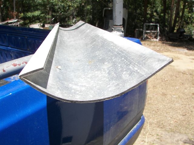

Here's a material I'd like identified.
It is two sheets of what appears to be hardened aluminium
sandwiching what appears to be Laminex.
I have several of these 'found at the dump' items and am looking to make a set of blades from them.
Any clues??

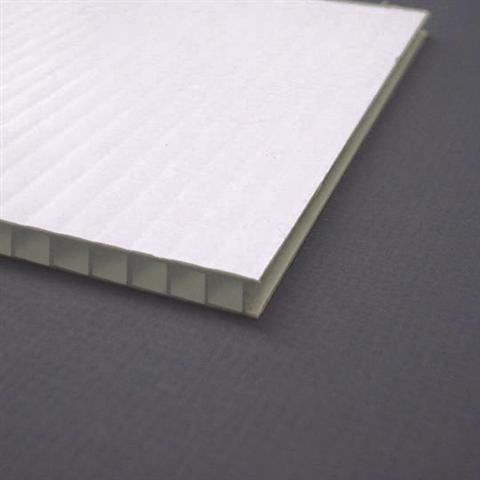

Hi Glenn, I think the stuff you were asking for is called corrogated plastic some brand names include Correx, coroplast, coreflute, corelite, fluteboard and twinplast.

Posts: 5200
Posted: 10:46pm 12 Jan 2008
Nup, you are both wrong.
The sheets come in different thichnesses, 3mm, 5mm, 8mm, etc. Its very dense, but very light. There are no visible air pockets, but you know its full of air. If you cut it, it behaves and looks like a marsh mellow. The skin is slightly harder and shiny. I'll send myself a message and take a photo of the sample I have a work.
