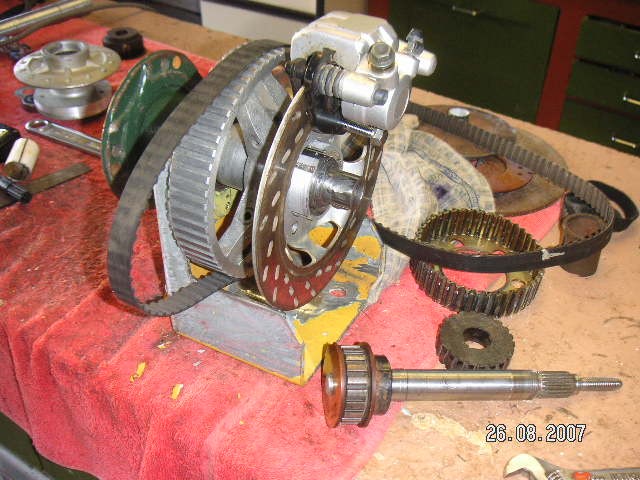

Posted: 08:54pm 11 Sep 2007
Hello Harold, sorry to hear of your disappointment. They look ok in the photograph,but !!.
Tell you what,, I got a set of Trev's fibreglass blades-why don't you come down here to Mt. Tamborine and have a look at them ?. You'll be impressed.
I haven't set the hub attactments in them yet,so you'll see what I'm going to do . I've half made the hub platform and disc brake ,plus the ribbed drive pulley.
I'd like to take up your offer on those blades,please save them for me.. I could swap you for something that would be useful to you.
But ,if you can't come down , Ilda and I could come up for the day and see you.
Bruce

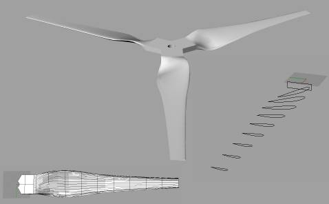

Posted: 10:03am 12 Sep 2007
Trev and I are finally starting to make some progress on a set of blades to suit the single rotor F&P windmills. Its been my fault, tied up with other projects. But the cad work is almost done, and the CNC router is all cleaned up ready to start machining.
Its 2.4 meters diameter, with a TSR of 6, profile NACA 2410.
Still some time away, I need to rout out the blank, then Trev can make some moulds to make the blades in fibreglass.

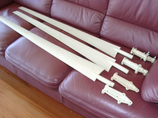

Posted: 10:30pm 25 Sep 2007
hi all, well i am in the US of A, my blades were delivered to the hotel today, and i am very happy with the one I unwrapped. It wants a file over a couple of small dags stuck to the fiberglass, maybe 2 minutes work.
I will be putting these together soon as I can after I get back to OZ, and will report back. If they live up to my expectations i will be buying one of the larger sets, maybe 3 m to gear up a F&P
cheers from a jet lagged Robert in North Carolina

Posted: 11:06am 31 Dec 2007
hi Bruce well they look pretty diferent to mine. i put mine up about a month ago on my chinese mill. They produce miniscule noise and are at least as good as the chinese blades. The windmill has been sitting on 6 to 10 amps into the 24v batteries for 5 days now with the southerly. i am looking forward to putting them on one of the F&Ps
cheers Robert
