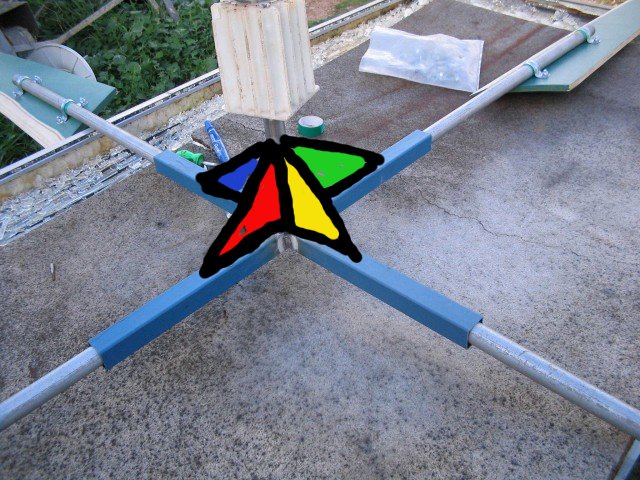

Well Dennis and I were busy early this evening quickly making some curved ply blades from some gear Dennis has bought. I've got 4 blades to setup on my folding tower next to my shed. As I was late getting home the pic's will be put on here tomorrow but these new type of blades do look promising. At the moment it's blowing a gale but whats the bet when the new blades go up murphy will pay a visit.

The angle the tip needs to be set is the magicial 3 degrees and this was easy to do as I have a snapon angle guage and I also used a laser to get the tips all set so they equal. What surprised me is when I went to balance them they were perfect and I didnt need to do a thing. . Now for the mounting Dennis suggested to use an old saw blade and weld the spline to it. I tried that first and found the saw blade warped badly, so scratching around my shed I found some RHS that fittied the gal pipe to a tee. So I fabricated the base and just welded on the spline, too easy.

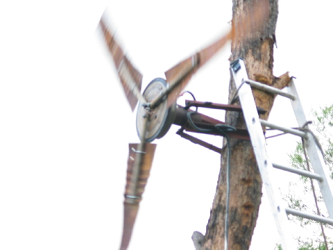

Vasi here is one of my very early ones using 200 liter drum segments for blades. It went quite well but the blades need stiffening. cheers Robert
