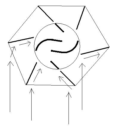

Larry
Joined: 08/12/2007
Location:
Posts: 2
Posted: 08:56pm 07 Dec 2007
I am working on this principle... 5 feet tall, 2 feet diameter... wind deflectors to minimize drag and maximize pull... geared 6:1 on a treadmill motor... I will be done in the spring... good luck...
Lar.
Gill
Joined: 11/11/2006
Posts: 669
Posted: 02:32am 09 Dec 2007
G'day Larry,
I see what you are trying to do and like your inventiveness, however feel that your design may not work as well as you hope for the following:
You have increased the capture area by adding vanes to intensify the power to a smaller central savonious. you seem to understand it is the more efficient profile hence the heart of the design. Perhaps with some further consideration you will see that a savonious of the same size as your total size would therefor be more efficient than a boosted smaller one. Both have the same wind capture area.
For a more even torque, stack a second savonious on top of the first but offset by 90deg. (Two @ 2ft 6in high.)
Your dimensions reflect a design style popular with some Poms at the moment, however the more efficient savonious are the opposite, ie. short and fat not tall and thin.
I understand this design is convenient for use of PVC piping however performance is abysmal considering it's capture area.
I don't mean to deter you from making your design, just make you aware of it's design characteristics.
Cheers Gill _Cairns, FNQ

Posted: 03:11am 09 Dec 2007
i have seen a system that uses a scroll as the savoniouse, there are numerouse blades set about 200mm apart on the outer circumference of the rotor, these can be varying in lengh
see http://images.google.com.au/imgres?imgurl=http://ecoenergysu pplies.com/images/gse_diag.gif&imgrefurl=http://ecoenergysup plies.com/vawt.html&h=195&w=200&sz=6&hl=en&start=151&um=1&tb nid=kCijg2a8F-hD_M:&tbnh=101&tbnw=104&prev=/images%3Fq%3Dvaw t%26start%3D144%26ndsp%3D18%26svnum%3D10%26um%3D1%26hl%3Den% 26sa%3DN
the longer you make the blades the more torque i believe
gill do you think the same, that the booster used here wont gain compared to one of total size?
martin
free power for all
McAlinden WA
Gill
Joined: 11/11/2006
Posts: 669
Posted: 10:21am 09 Dec 2007
martinjsto,
What you are doing by increasing the height(length) is increasing the torque but only by the fact that you have increased the capture area. This tall height is primarily to make up for lack of torque because it is designed for higher speed.
So basically a short fat savonious will have higher torque and slower speed and a tall slim savonious will have higher speed but lower torque for the same capture area.
I'm calculate that by adding the fixed vanes they increase the capture area but maintain the high speed turbine profile. Very clever!
Be aware that these vawts are aerodynamically designed, your sketch was not. Their turbine has multiple blades also aerodynamically profiled, your sketch showed a simple savonious. Whilst I now see what they have done, I would be cautious of just slapping something together that looked close. Still a very interesting project if you're prepared to get into the figures.
Good luck with it.

Megawatt Man
Joined: 03/05/2006
Posts: 119
Posted: 07:49am 18 Dec 2007
Hello Gentlemen, Look at this link, its been mentioned on this site before. http://www.gual-industrie.com/Doctechang.pdf
This one impresses me. One of the problems with VAWTs is that they have a tip speed ratio of less than one, ie the velocity of the outer surface of the rotor is less than the velocity of the wind through it, unlike the HAWT. When you channel the wind through, as with the device on this link, you use the Bernoulli effect and that increases the velocity of the air flow through the blades, so you increase the TSR with consequent increases in output etc. The arrangement really does look like that you see on gas and steam turbines. I would reckon that very much theoretical thought, capped off by very much experimental work has gone into the creation of these machines. I would guess that we couldn't just scale off the shape and dimensions from their pictures, because they would have wanted to protect their IP, so maybe they would have changed the vertical/horizontal ratios before publishing the pics. But I reckon its the way to go. They can be on the roof, or on an exposed hilltop at ground level. They can't fall over the fence. But I reckon if you had one on the ground, you'd need a mesh fence around it smaller than your dog. Incidentally the TSR limitation is because the back of the blade must push its way through the oncoming wind before it rotates to a position where it becomes the driven blade. When you use incoming guides, you can arrange them so they shield the back of the blades on their return journey. The Chinese found that out some 2,000 years ago with their bamboo VAWTs that they used fir irrigation, they built mud brick walls to guide the wind in and protect the rear surfaces of the blades. Of course the walls had to be on the side from which the prevailing winds blew.
So what we need is an experienced fluid flow person to do some numbers on the concept and tell us what shape the rtotor blades and the guide vanes need to be. I don't know whether the other link posted was for the Russian VAWT that was posted maybe a year ago. It was of relatively small diameter and large height and it sounded like an air raid siren while operating. That won't happen with the larger units, because of lower rotational speed at least.
Megawatt Man

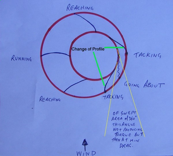

Gill
Joined: 11/11/2006
Posts: 669
Posted: 12:13pm 18 Dec 2007
I am of the opinion that for a VAWT to be successful it has to harness the wind from most all of it's swept area. If it fails to generate torque on it's approach to wind it is merely a drag machine. The example I would liken it to is a sailing yacht. What degree can the America's Cup challengers sail into the wind? Is it not something like 5deg??
With a 360deg change in relative wind direction to the turbine blade, I feel that like a yacht's change in sail profile to suck out the power, a VAWT needs to change each blades profile as it changes angle to the wind too.
Hence my inclination to a flexible blade skin. But I dream to much.
The used of deflection vanes to make the wind change to suit a fixed blade's current angle must reduce the available power. If it sacrifices some power to apply it to a smaller swept area for the purpose of higher revs, well and good. But I can't see where vanes can increase power over a turbine of equal capture area, and certainly not 3 times the power. Perhaps on a poorly designed drag machine.
One thing for sure, designing a new successful VAWT won't be easy.Edited by Gill 2007-12-19

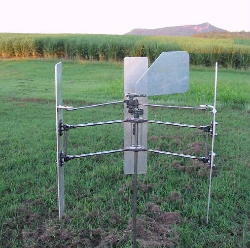

Gill
Joined: 11/11/2006
Posts: 669
Posted: 04:26am 20 Dec 2007
This is my idea of changing profile. Applied to Glenn's early HAWT
Edit: Ooops! topmost sail/vane is back-to-front.
If you've ever done any sailing you'll immediately understand the terms and aerodynamic profiles. In basic theory this should produce torque for most of the 360deg.
In reality there are considerations of relative wind flow as well as changing flow through the turbine itself. Still I feel a turbine with an adaptive flexible profile such as this will cope with these without the need for the DIY experimenter to have a degree in aerodynamics and a wind tunnel.
And before you say it, I agree, All those working parts are a minus.
But any comments on the principal idea? Edited by Gill 2007-12-21
