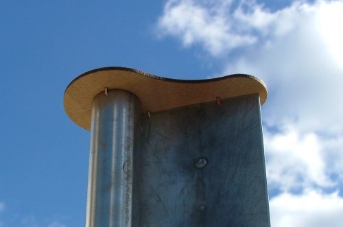

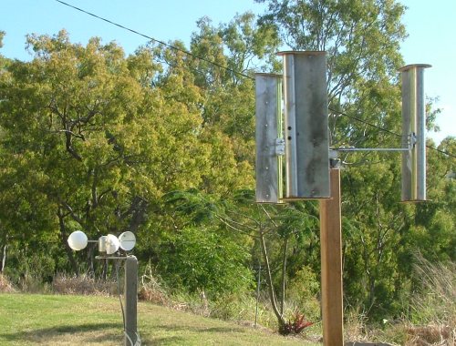

Last week I threw together a little experiment vertical windmill, based on the Lenz but using closed pipe. It didn't work very well, it would run as a drag windmill, very slow, and if I spun it up by hand it would then run as a lift windmill. However it couldn't get into the lift zone without some help from me, and thats not what I wanted, so I abandoned the idea for now.

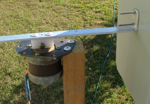

I wanted to play with the Miller turbine again, there is something about this design that has got me interested. I made a adapter from HDPE ( same stuff those kitchen chopping boards are made from, easy to work and cheap ) to fit a stepper motor.
The little miller runs well, makes about 3 volts. I've been watching this thing all weekend and I'm sure its a lift windmill, once started it keeps speeding up like a Darius windmill.
I've attached a little video of it running.
