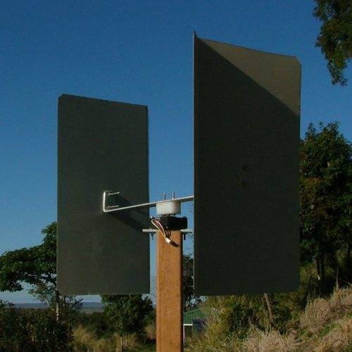

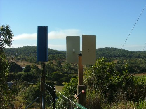

Hi all.
I put together a small Miller Rotor as described by RonS. I stuck with the 1.6:1 ratio for diameter and chord, and my wings were 200mm long. Its driving a small stepper motor, but I'm realy just using the stepper motor as a ready made bearing. I stuck it on a post about 6 meters from my little Sandia Savious.
In the background you can see the Sandia. The Miller starts up OK, needs a little more wind than the sandia, but once its going it matches the sandia for speed. I think the Miller needs some more investigation, it appears to work OK and I would like to apply a small load to see how it performs.

Great to see people trying the Miller. Glenn, you might like to experiment with putting the vanes closer together so that it starts in weaker airs.(But you will lose some torque, of course. )
Regards, RonS

Gizmo out of curiosity,
What is the vane shape of the Sandia sav.?
Never heard it mentioned before.
Have fun with your experimenting.
Posts: 5200
Posted: 12:19am 18 Jul 2007
Hey Vawtman
Check out my photos page here, bottom left of page. There is a small video and the plans, I think I originally found them on fieldlines.
The sandia works very well, starts in the lightest of winds and spins faster than TSR 1, so must use a little lift as well as drag.
