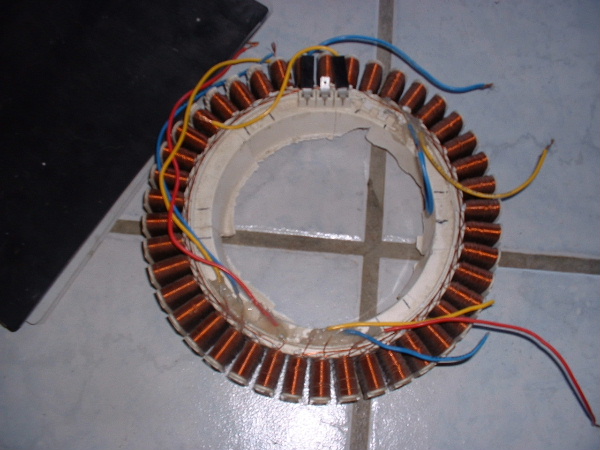

I remember when I visited you Trevor you explained the 7 pole config to me but I am very hazey on how to wire it . From your figures 7p star looks good for getting volts up quickly and 7p delta for when power is avail from wind strength . Could it be wired as 7 pole star/delta and use eccoin's switch to change between str / dlt . Have you a sketch on the 7 pole.? I had considered series the two after rectifing would it be possible to join a + & - from bridge rec and double the output volts in DC , it seems simple but would you need 3 Phase bridge rec's on both stators so the output is the same ?
-----...Regards...Phill...-----
PS .. Trev I did a bit of searching though the posts and found Glen's diag's of 14 & 7 pole from 6/1/06 and shows the star and delta you explained I think . Will have to try and work out series/parrell and how to switch ... Any ideas muchly appreciated ....Phill....Edited by fillm 2007-07-17

To do the star/delta switching you need to have ac wires down the pole from the delta formation. One end you take power from all the time, and the other end can either take power (delta) or be connected together (star).
It is also possible to series the dc output in low wind and parrallel the dc output in higher wind at the bottom of the tower. Yes you do need to rectify first.
Too many choices hey!!!!!
Here is a pic of the simplest way to make 7 pole delta. There are a few wires missing, but I'm sure you can work it out. You should have a total of 12 wires out. The 2 halves can be parralleled, by phase, reducing the number of wires.
Trev @ drivebynature.com

Thanks , I printed of the diag from 6/1/06 and took it home and scratched my head for a while as it was not anything like I remembered about spliting the stator into two halves anyway it shows the same as a 2 pole but said 7 pole ... I sat down with a busted stator and came up with exactly like you have shown . I thought I would go with the whole stator in star or delta and that would give 6 wires out for one stator and 12 for two if bringing AC down the pole, and switching from star to delta at the base. Whats your thoughts on two stators 7 pole delta into 2 x 3phase bridge recs that are have the DC terminals in + - < joined > + - to get the amps up at 48V at lower RPM for big blades ?
