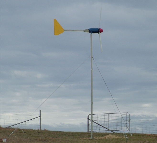

Picture of mill ONE, before tail mods
Sorry about the changes, trying to get the pic size rightEdited by KTee 2007-07-15

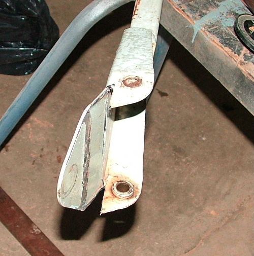

Checking the tail angle.
hold the tail arm against the stop on the housing and sight along the axis of the generator. The tail should move away from the axis by appoximately 10 degrees
I've got a few pic's for you, they say 'a pictures worth a thousand words'
you can see how Dave (my brother) cut the tail arm to get the added 10 degrees. just weld a filler in the slot and a splash of paint if you are so inclined.

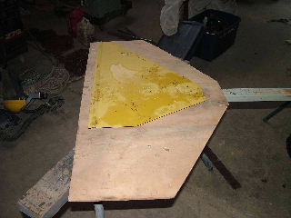

The tail size
The tail was cut from some scrap ply in the shed. I think it was 7mm thick

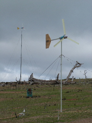

Pic of the 2 mills, mill ONE is in the fore ground.
