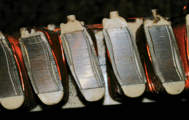

Can someone please provide some simple instructions for decogging an F & P smartdrive motor. I have looked at the pictures in the Backshed site and have concluded I am stupid, because I'm unsure of the procedure. I have done one face (the inside) but it does not seem to make any appreciable difference:
a) Is it just the top edge of the magnet that needs chamfering, along with the plastic, or do the inside edges of the magnets need chamfering too?
b) Do both the side encased by the rotor AND the forward-face have to be filed?
c) Is the shape critical?
Look forward to your usual splendid advice

This picture here shows a close up of a decogged motor I did. Its a big picture. http://www.thebackshed.com/Windmill/images/Dscf0548.jpg

Gee mate you don't go chamfering the magnets. nothing is done to the magnets for de-cogging.
The modification for de-cogging is done to the stator.
The stator has Poles that stick out like fingers all the way round. The wire is wound on them.
What you chamfer is the steel edges on the very end between poles. This makes the edges of the poles slightly rounded.
In the picture, see how one pole has been de-cogged but the one on the left has not.
Only the long edges between poles are modified, the short edges are not touched.
Hope that's helped.

Gill - please resend the picture - it is not loading

No doubt about it Herb the pole pieces can be easily twisted. I have a segment cut from stator and I found it easy enough to twist a pole piece with a 15" Crescent.
There would be a few challenges to do a whole stator though but I guess it would be feasible with some sort of special tool that would fit over the top of the pole piece and cause a bit less damage than the spanner did.

Like this you mean Herb? You could do a much neater job with some sort of tool that would fit right over the top of the coil, maybe just a heavy enough piece of channel steel.

Looking at your photo John it would a so be better to file the plastic back that protrudes slightly outside the pole face

After the usual steps backwards (no pun intended)the merits of twisting the steel laminations versus profiling the sides seems to have settled very much in favour of the latter. We made up several versions of a hollow box-section tool with a handle, but every one of them bent before making any appreciable difference to the alignment of the laminations. This does not mean it cannot be done, but is would require a case hardened tool to be strong enough, yet thin enough to work without fouling the coils and doing damage.
Using a sharp 1.5" half-round file, I reverted to profiling the sides of the laminations as advised by various of you - problem largely solved. The entire profiling job took only 15 minutes and the half-round shape used flat-side down gave plenty of control without having and appreciable edge thickness to get in the way. I rather doubt it would be worth paying $100 plus for a power file
The cogging was reduced by an estimated 70% and although it still takes some initial effort to overcome the first cog, once moving the unit picked up real speed and the voltage output was excellent
