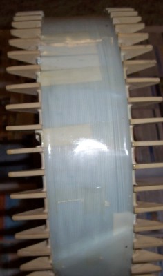

Pic of the first stage of re-configuring the windings --more to come,,,
)Oh well ,, pic has to rar zip -- allways something different to what I've been doing in the past like .JPG-- -- --the're out to get me-----
I'll get over it =promise"

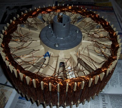

Ok,, over that bout of computa stress-- now ,,down to business.
I unwound the 1st and 2nd coil windings completly--u could keep the wire or discard it -I discarded it ,,as all the crinkels and bends will add bulk to the final windings..
I will cut and "tail-out" starts and finishes of the coils I want to connect to bussbars for series-parallel connections-- same as F&P re-windings...
You will have to purchase some appropriate enammeled wire to re-wind the second and third phase winding coils --- or re-use the recovered stuff , straightening it out carefully ...
So, that's about it ,, a time consuming job ,but quite simple , every coil has 38 turns , so that means the frig door should be opened ,,Oh ,, what the heck !!!

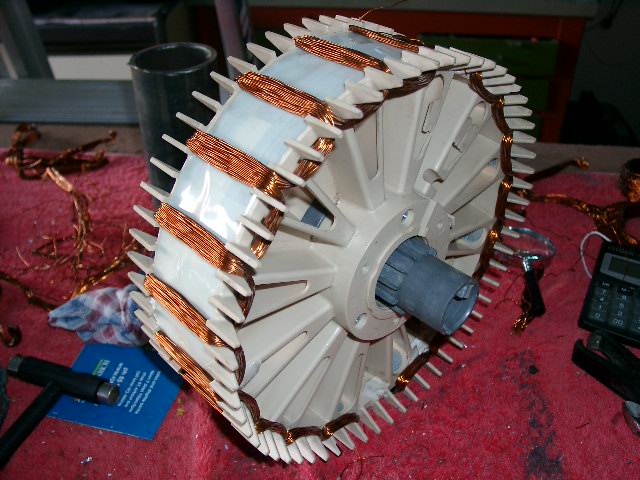

Hey Bruce,
well that was a pain in the ass.
Here it is finised, hooray
prepare yourself for sore fingers. There is a little trick that all rowers will know leukoplast your fingers first.
Pity I can't drive it
Ever thought about selling those seeley shafts Bruce?
