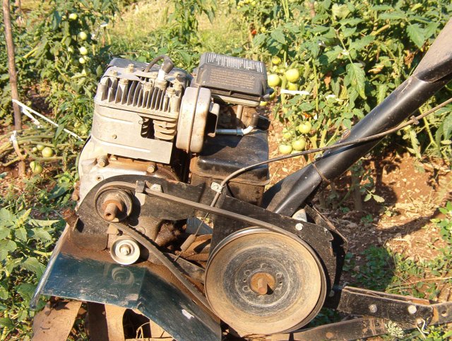

Hello guys, this engines have propeller for cooling?
I have a small front-tine tiller that I use in my vegetable garden (a gift from my uncle - Brigss and Straton engine) but I can't run it more than 2 hours because don/t have propeller for cooling.

Hi Vasi
I think the Briggs and Straton engine has the fan (i.e. propeller) moulded as part of the flywheel?
Maybe you are only missing the cowling and I think a practical person could make one of those?

Hi Vasi
Can you able to post some picture of Brigg and Straton engine and how many KW or HP output ?

  dwyer said   Hi Vasi
Dwyer the Bushman
Yes, very soon. For now, engine have (had ) 5.5 hp. My brother used it without respect for "user manual" <-- this smiley is too happy for that.Edited by vasi 2007-07-02

  KiwiJohn said   Hi Vasi
If is one (propeller - maybe connected on starter) is not enough because running time is 40 minutes then 10 minutes pause.
I will send another one from the other side (this one I had on computer hdd). Edited by vasi 2007-07-02

Hi Vasi
What this engine worried me this American engine Brigg and Straton design to run very hot than Honda engine so they will wear out sighing quicker so when engine slowing refuse start over the time reason is until no compressor left in the cylinder is worn out so anyone will have to force to throw away or replace motor or buy new one and this design by Brigg and Straton to keep the business going and other secret on engine timing is away out of adjust (approx 20 deg out) at high rpm design to wear the engine quicky and of course hotter and this was post on webs site fews years ago Only thing you can do when engine start to get hot simple spray fine mist of water on top of alloy cylinder head while is running until cool down but spark plug cover must be waterproof. Anyone to find out about this horrible Brigg and Straton engine is some where on webs site so good luck .

Posted: 06:51pm 01 Jul 2007
Yes dwyer, you are right. I already have starting problems, loosing compression.
Few days ago don't started at all.Edited by vasi 2007-07-03
