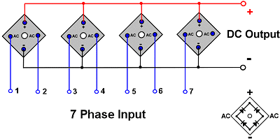

As far as I know bridge recs are one way diodes put together in a nice little black package.
pic courtesy of Glenn
correct me if I'm wrongEdited by Highlander 2007-06-20
