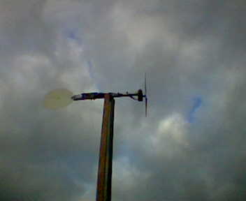

finished building a minimill as per the web site instructions, got it up in the air, but as usual no wind since I put it up.

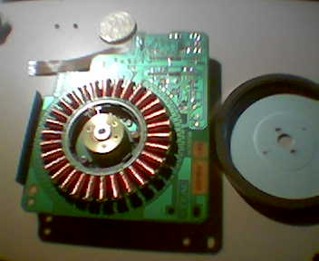

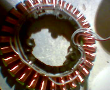

Had a look at the other motor in the FDD and thought it looked a bit like a f&p / sealey, thought I might have a go at doing something with it..

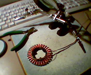

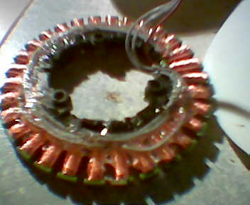

pulled the board off it, and started to rewire it to star config..
bit of a fiddley job, yes that is a magnifying glass, eyesight not as good as it was...
got to practice my soldering, bit rusty tho, slaped some selastic on it

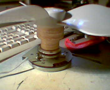

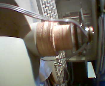

Made a boss for the fan blades out of a bit of pine,

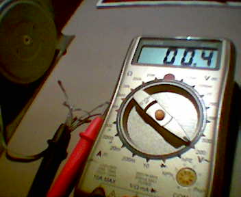

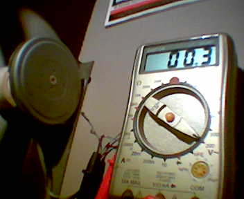

and spinning it by hand can ger 0.6 volt AC out of two of the 3 wires( not quick enough to capture it at 0.6, only got it at0.4 and 0.3 volts
will get a bridge rectifier or 3 and see what it will do, well that waisted a day or two, will keep you all posted when I finish it.

Good work Grolly. Sorry to hear the days work was a bit low on output, but its all a learning exercise.
If you have another one, try using it in standard trim first, see what voltage you get before you reconfigure it.

Hi glen, did run it as is, got 1.3 v ac, thought I could improve on it, well we will see when I get a dc output.
