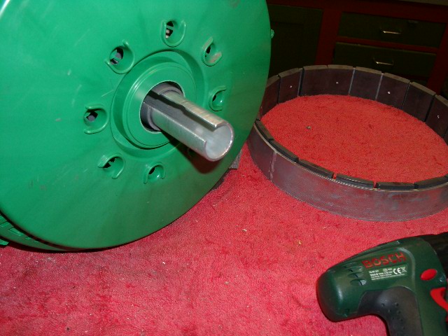

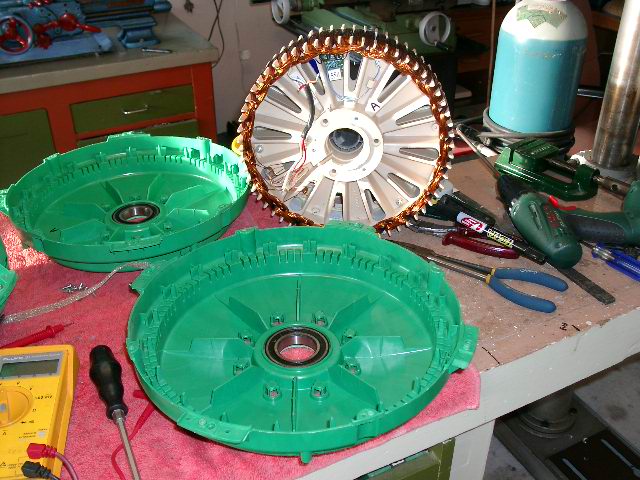

Hello crew,,

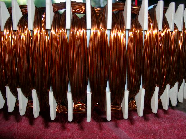

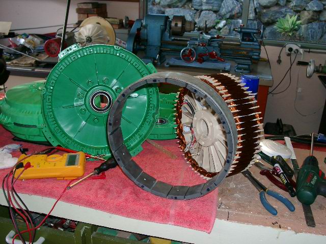

Dennis Latham packaged a few or these new "Seeley" motors and they arrived today --very professional job,Dennis--sorry to junk the boxes-glued together so well had to bash them apart --sorry.
Anyhow,,,pulled one 500 watter apart and from first impressions,wow.
the magnets are huge, the windings are around the F&P .8mm size. the bearing are huge --will last our lifetime,70mmm od -42id. but one observation from experience--I'm going to remove the dust seals,as I really don't think these are needed at 50 feet and did you know they increase the friction by "heaps"..but that's my opinion..
these motors are much bigger than Fisher & paykel washing machine motors ,so be aware that you are going to need (in my opinion) much bigger blades for start-up but once they get going ,,,,well,,, who know's yet,,????
Anyhow ,, a few pic's of what I saw 1 hour after the courier delivered them ---

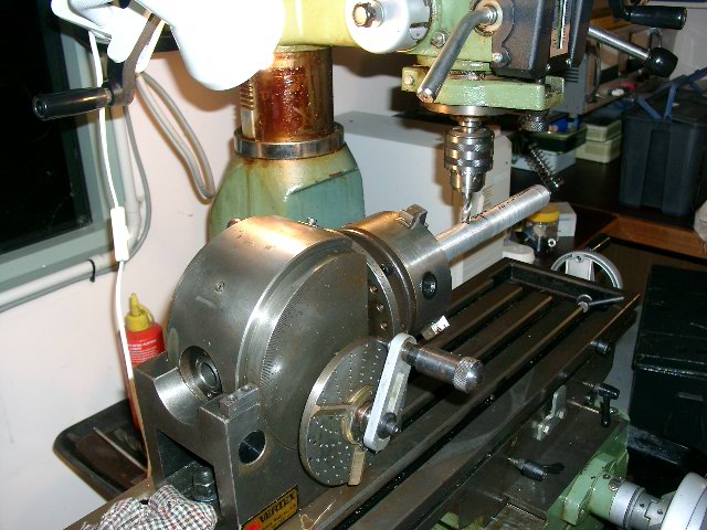

how about that ,,just came in from the workshop milling a shaft to fit the "Seeley"---
Used a piece of thick walled 32mm Aluminium ,put it in the lathe and dressed it down to a snug fit of 31mm ..
Took it across to the milling machine and am in the process of milling a slot of 10mm length-wise for the "stops' internally moulded into the flange bosses.
Handbrake was yelling ,,so had to come inside --that's life. lol.

finished milling the shaft this morning --fitted nice and firm ..
removed the plastic seals from the 4 sides of the 2 bearings --wow , what a difference--would recommend it to u all ,,,as from my experience, you can get these bearings easy ,, and , anyhow ,, they (un-sealed) ., are going to last you many years --in my opinion.

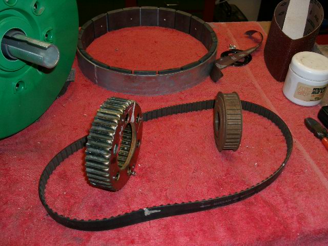

This is a pic of the timing belt and pulleys I might install.
1:1 at this stage , but could be changed..

Bruce, Is there a steel band hidden under the copper coils in the plastic ?
brucedownunder2
Joined: 14/09/2005
Posts: 1548
Posted: 07:31pm 30 May 2007
H Feral,,

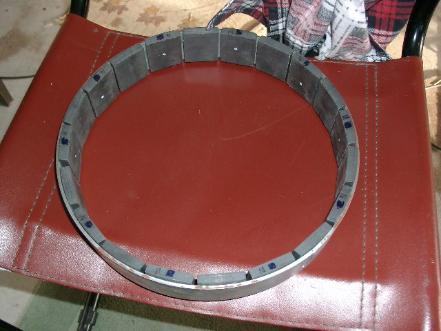

Yes there is -it's fairly typical for these big diameter stators to have ,what this has, a wide binding of hard drawn steel wire coiled tightly just inside the coils to felect the power towards the magnets(I think).
This particular wire is a polished steel,very hard ,very springy not electrically connected .
Also for anybody's interest ,there appears to be some sort of speed control/sensing "thingo" (can't see it ) , that is installed between the back steel banding coils and the back of the copper coils(in between)- this terminates on a pcb that is rj45 jacked out via a cat 5 (think) cable .(this cable was just cut off when I received the motors.
