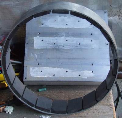

Dennis phoned this afternoon, he's found a new type of motor from a domestic appliance that looks like it may give the F&P a run for its money. He sent these photos throught tonight.
Dennis has found heaps of these motors, the 500 watt model, but they are due to be crushed in the next day or two. However they can be bought for $20 to $25 each, so Dennis is after expressions of interrest. He said he can get the motors put aside hopefully, but anyone who wants one needs to contact him. His home number is 08 838 21658 ( SA, Australia callers only, take into account the time difference ). Or email dlatham@chariot.net.au
The motor looks like a air core design, no lamination poles, and therefore no cogging. The stator is 100mm high ( 4 inch ), each magnet seen in the hub is 58 * 42 * 10mm.
If your interrested in buying a few, give Dennis a call before Lunch time tomorrow ( Friday 18th May ). I dont know anything about this motor, but it looks real good, might make a great windmill alternator.

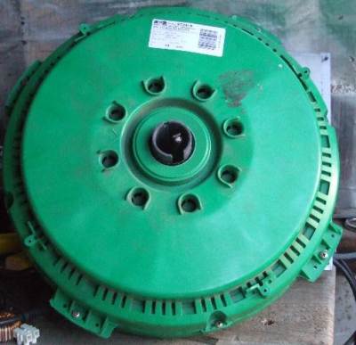

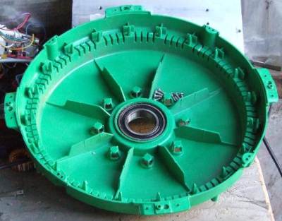

Apart from the information with the photos you will need to have strong tower with as mentioned above plenty of torque at low speed. They mount on a round 40mm (aprox) pipe which goes right thru the unit and will be excellent for the tail and fixing to your tower.
They have an overall diameter of 370mm by 160mm thick and weigh in at 10 kg. The F and Ps weigh 7kg.
They have 2 outer plastic sides which are easily
pulled apart. They are not waterproof. All models look the same from the outside.
The magnets are loose as the as they are held in place by the dividing posts. They would be dead simple to change.
The 20 magnets are 58mm high by 42 mm wide and 10mm thick being north and south facing side by side. The removable outer steel ring is heavy duty and much better than F and P. This set up nearly falls together.

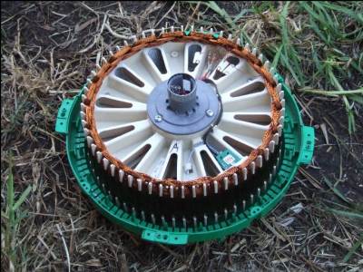

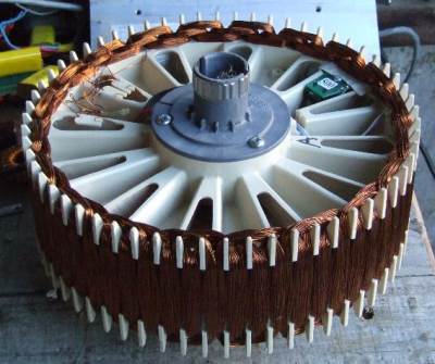

The 60 coils are 100mm long and overlap adjacent coils not unlike a regular motor. (Not like F and P) There is twice as much wire used with it being the same wire diameter as the 80 series. They are 3 phase Star with the delta ends being easily accessed. They obviously can be reconfigured but it is very early days for this.
At this very early stage I have not run one. When turning a Model 500 manually there is no cogging (NO COGGING). It feels like a slightly tight bearing but is as smooth as. Yet to see how it fluxes?
They state they are extremely quiet. Have not heard them yet. The larger output units have NEOS.

Hi All Some more info. Since I am stripping ,cleaning, rebuilding and checking the electrics I have found. The first 6 completed all had there cover plates busted and one had a broken wire from a loose magnet. Apart from the above and being dirty they were fine.
Here is a bit more technical stuff.The units are described as being a Brushless DC Motor. As an electric motor the 500 watt unit draws 3.5 amps which in theory should produce 840 watts as a generator with a blade capacity of about 1 HP. ( Speed / Torque ? )
The big 1500 watt draws 9.8 amps with an output of 2280 watts with a blade capacity of about 3 HP.At this stage it is still very speculative however they are serious machines and as said before will require big gutsy blades.
Some other answers. The green covers which have the magnets between them rotate around the fixed centre pipe ( not shown in photos).This long pipe will be about 43 mm with the 3 output wires going into it and out past the covers and into your rectifiers. Each of the 20 magnets spans 6 legs of 6 coils but I have not properly researched this.

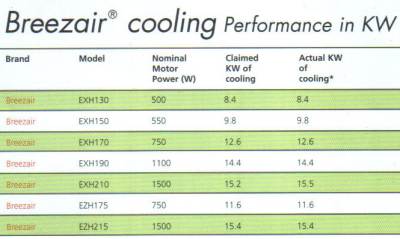

Good morning ,, was thinking about these motors last night..Something just didn't sit right,!!, anyhow I finally understand ,. They are the motors that are in thousands of those ugly brown boxes on top of house roof's--We don't see them here in Qld ,so that's why i was confused.
They are purely for driving a cylinder fan that cools the water that cools the air,(I think). ahhh, Evaporative cooling system...
No wonder there are hundreds of them in South Aust., thats the major user and manufacturing plant .
Now I know why the shaft is not available--it's also a major part of the fan ,so,if a motor needs replacing ,then the shaft stays and just the motor slides off and the new motor slides back on the existing shaft..(I think).

Hey guys, just found this picture, looks like the motor inside
"The incredible electronic technology and revolutionary HushPower motor mean that the Breezair Icon series can cool a whole house from as little as the cost of running a light bulb"
