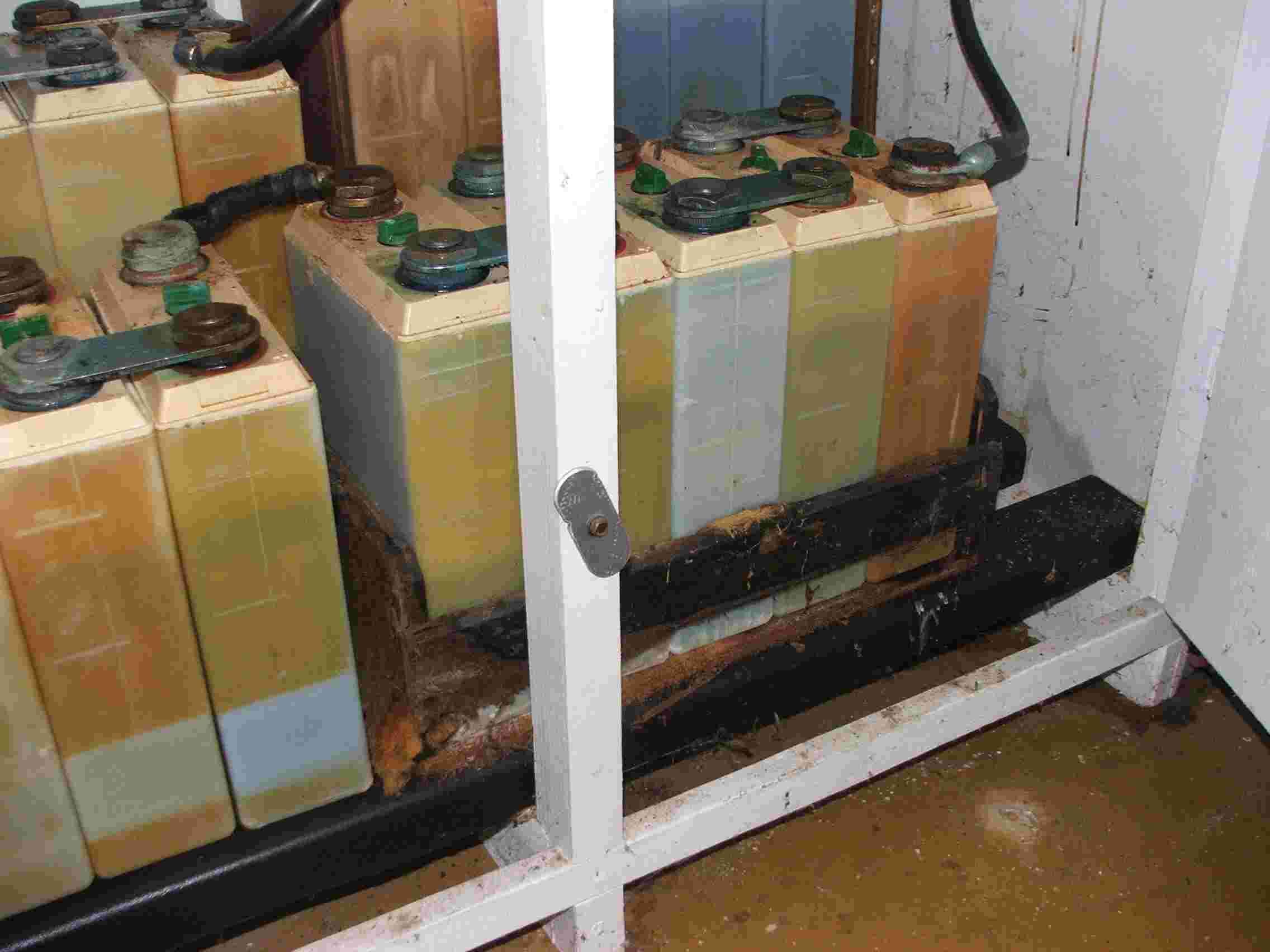

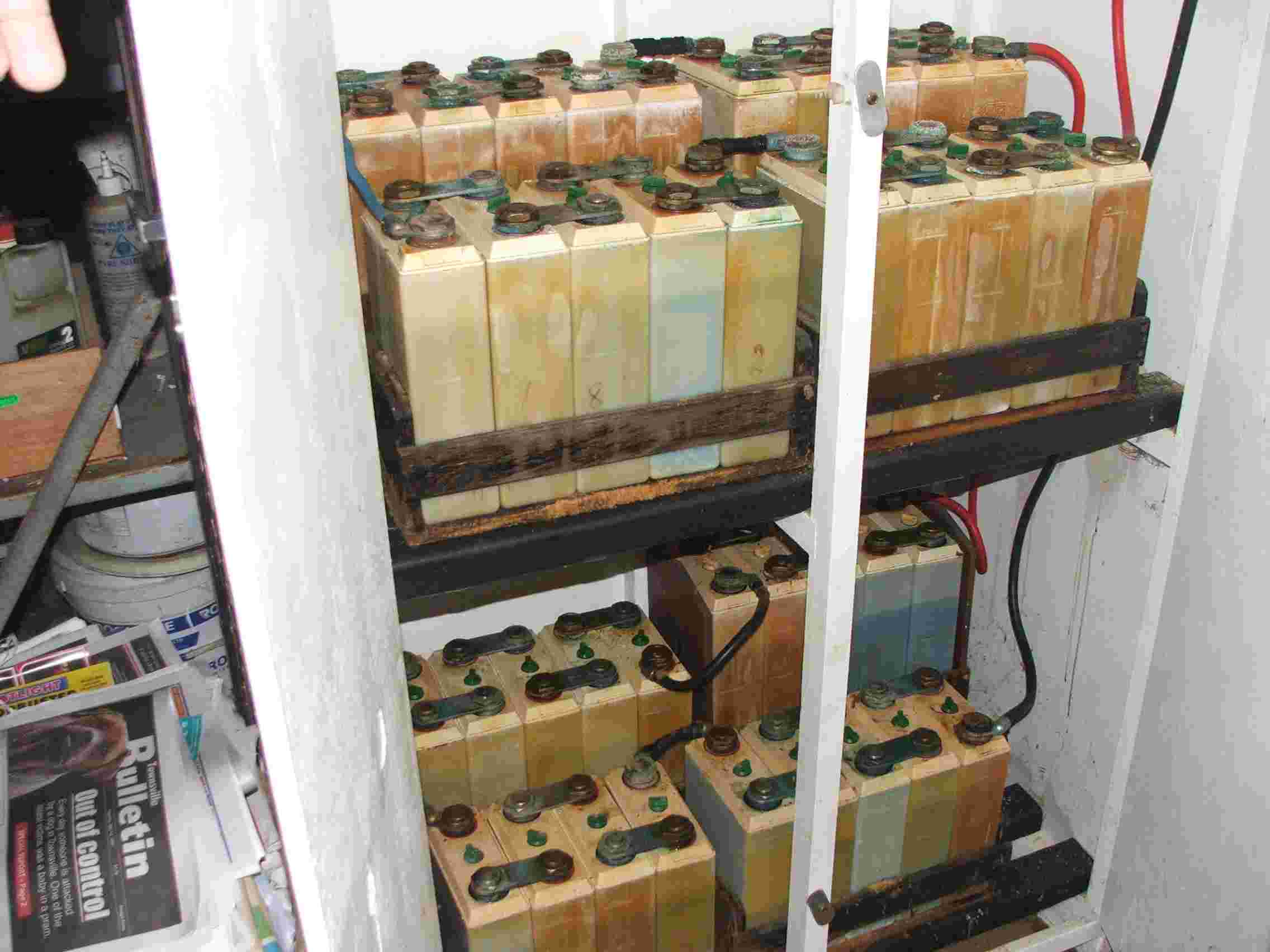

Hi Phill,
As these batteries age, they do develop cracks and leak. It eventually becomes a nuisance and they will need to be scrapped. It is possible to fix up some at the beginning of the failures by using hot melt glue, but eventually repairing becomes unviable.
See pics of the bank I have now decommisioned.
