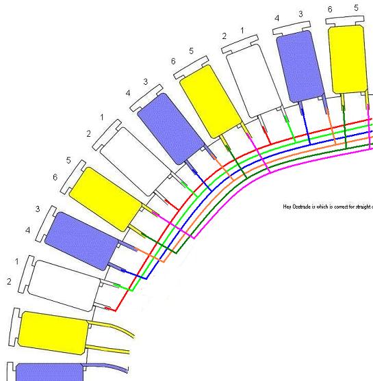

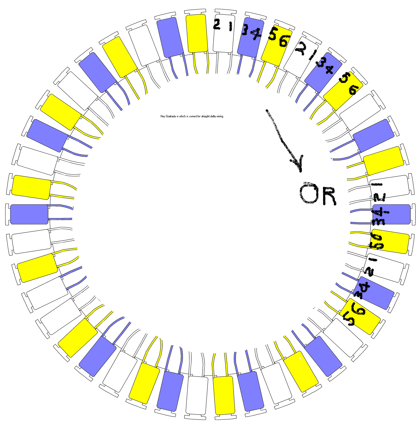

Recently you replied on this forum re delta wiring of an F & P i have just done a scetch of what i think you said, but not sure which wiring is correct top or bottom

Not quiet right - try this

Greg, that looks to me like each phase is 14 coils in parallel, does that produce a useful volage at moderate revs?
I understood the practical configuration was each phase wired to be seven paralled pairs of series connected coils?

  KiwiJohn said
Greg, that looks to me like each phase is 14 coils in parallel, does that produce a useful voltage at moderate revs?
I understood the practical configuration was each phase wired to be seven paralleled pairs of series connected coils?
Actually Bob, John is right. What I have described is a parallel circuit - but the term "delta" is referring to a parallel circuit, there are several ways to configure a parallel circuit. The method I described starts producing current at around 450rpm, 600+rpm before you start getting a useful current - 600W @ 800rpm for and 80series.
Another method is much simpler and starts giving a useful voltage at around 300rpm up to around 500W @ 1000rpm.
The method is:
  • Free all six wires at the termination points.
  • label each wire 1 - 6 in a clockwise direction.
  • connect wires 1 & 5
  • connect wires 2 & 6
  • connect wires 3 & 4
However, the method that Glenn gives for rewiring star/delta is probably the most practical and versatile an efficient. His method can take adavantage of a star/delta switch that switches between the to modes. This way you can take advantage of low rpm to produce power in star mode, then auto switch to delta for high rpm efficeincy.
Basically, if your expect to operate at low rpm most of the time, you should choose a star circuit. If you expect to have high rpm available to you most of the time, choose a delta/parallel circuit.

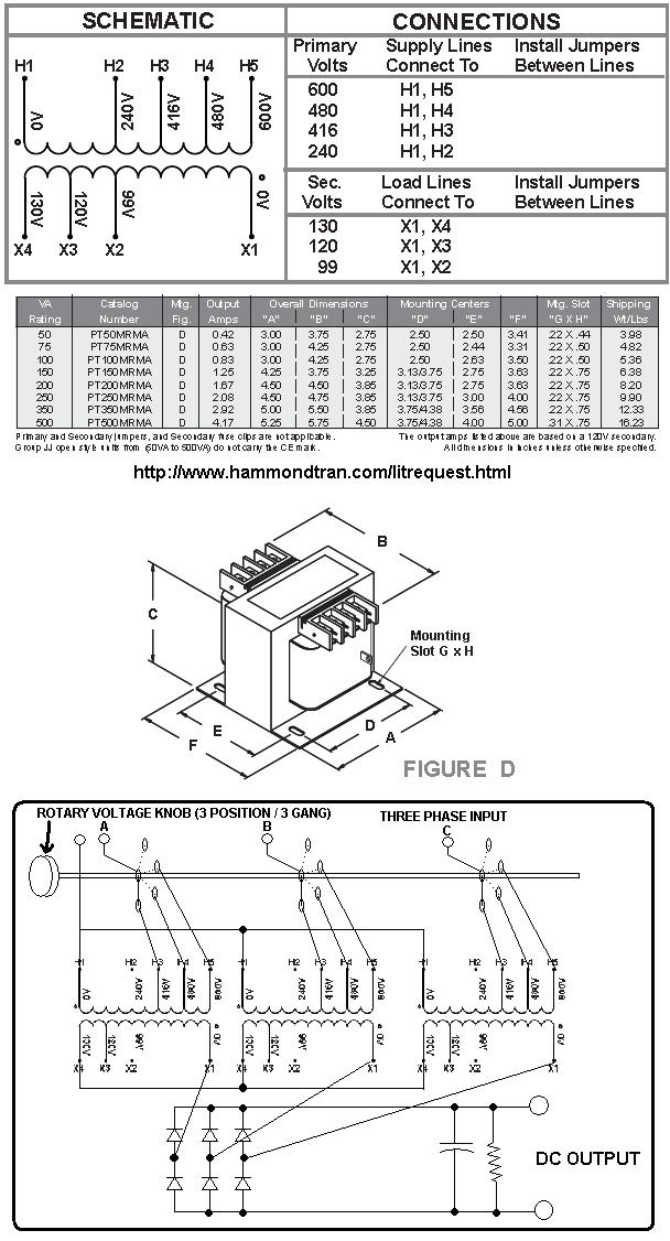

solarmike
Joined: 14/11/2005
Posts: 26
Posted: 02:25am 06 Feb 2006
I am interested.
You could use three small high voltage stepdown transformers that have multiple voltage taps and connect them up to a rotary position three gang switch and rectifiy their output through a six diode bridge and filter it with a capacitor and a 47K ohm discharge resistor. This will allow you to experiment with various voltages.
Cation: if you select the low voltage position There will be a lethal voltage on the higher input taps. Be very carful.
Good luck!
