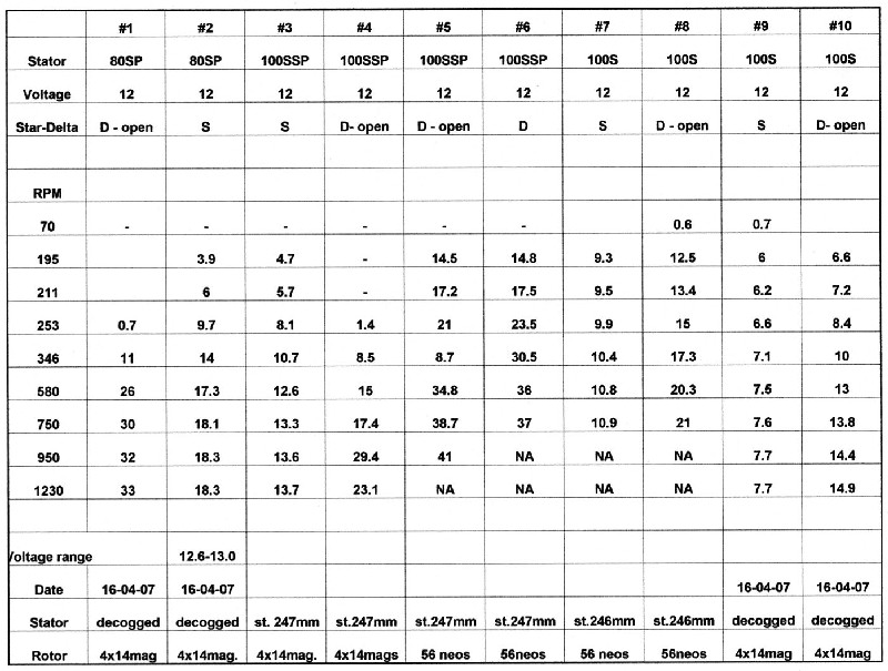

here I go again.
I have printed and scanned it as jpeg.
#1: decogged,rotor 4x16mags, rectifying each leg separated via 6 pair of diodes, I call it open delta.
#2:decogged,rotor 4x16mags, star rectifying
#3: 100SSP- each phase 7poles in series and paralleled,
stator OD reduced to 247mm with an angle grinder.
star connection
#4:100SSP- each phase 7poles in series and
paralleled
rectifying each leg separated via 6 pair of diodes , I call it open delta
#5: 100SSP- each phase 7poles in series and
paralleled
rotor: 56 neos, I replaced the first generation rotor mags (56single mags) with same size neos angled them about 20degress.
#6: 100SSP- each phase 7poles in series and
paralleled
delta connection
#7: 100S - star connection, rotor: 56 neos,
stator OD 246mm
#8: 100S - delta open, rotor 56 neos,
#9: 100S - star connection, stator decogged,
4x16 mags
#10: 100S - delta open , stator decogged,
4x16 mags
NA: the lathe could not start it.
One interesting info here is you don"t need a complicated star- delta switch to change over just recify via a pair of 3-phase rectfier ( I used a pair of car alternators)
In star you don't connect the phases together and to switch from star to delta you just need an ordinary tripple switch- opening the star connection.

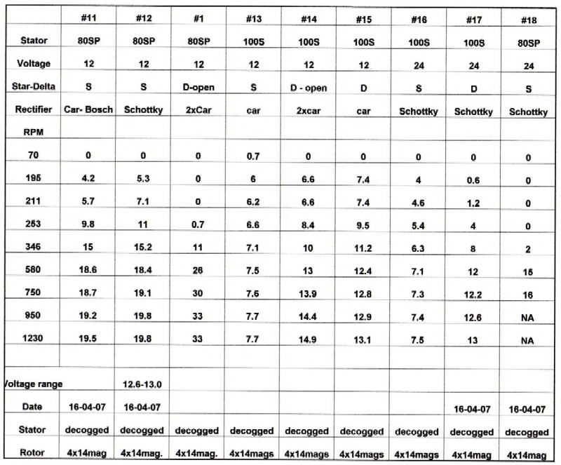

Here are some more results:2007-04-19_203225_Smartdrive_data_#9.zip
carl1
Joined: 16/04/2007
Posts: 79
Posted: 10:55am 19 Apr 2007
Looks like the Zip file didn't work.
here is it as a picture:

Hello Harald,, thank you for the work above ,well done .
Looks like #5 would be the best allrounder??.
I'd like to see and know more about the way you made your Neo Magnetic Rotor,? please. I made 2 and the first one works very well in a decent wind ,the other is a failure because of the spacing I made in attaching the Magnets --too wide by ,say,1mm. -anyhow next time!!.
Bruce

First some correction in the tables for output:
#4, 100SSP, rpm@950 must read 20.4
#5, 100SSP, rpm@346 must read 27
#14, 100S, rpm@211 must read 7.4
#15, 100S, rpm@211 must read 7.1
I did some more test:
1: regarding shunt regulation:
I did a one hour test run on an 80S unit without being connected to a rectifier at 1200rpm:
The temperature of the laminats ( steel core ) rose to about 60 celsius, coppercoils did not heat up.
seems to me like you could run it disconnected from the rectifier without any damage.
But watch out for the open voltage at the connections.
I measured 580 volt with an 80S-star- @1200rpm
and 85 Volts with an 80SP-star- @1200rpm.
The output of the 80SP-star one phase disconnected from the rectifier was reduced by 50%: @1200rpm 11amps.
I changed the rotor from a grey one to brown one:
The brown one had 1.3 to 0.8 amps more output.- 80SP -star.
Looks like magnet strength varies a bit.
cheers
