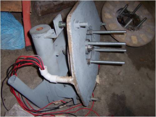

I just got some magnet discs laser cut yesterday and have started to build a piggot turbine Has any one tried one of these??? any hints or observations would be helpful. I already have a trailer hub and the magnets.This my first atempt at building a turbine so I will post progress and results as time allows.Thanks for any input Mick.

Have started the work, magnets are glued to the discs ready for casting in glass, have cut out the stator mould and made the gig for winding the coils next job is to buy the wire and wind the coils then I might do all the glass work at the same time

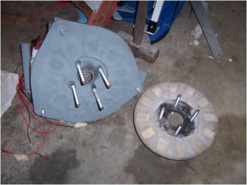

Just broke the stator out of the mould am very happy with the result after a bit of worry last night,did you make it from scratch as per the book any problems you had let me know,next step is to find the steel and start cutting and welding Mick

Happy fathers day to all I am happy as today I put my bits together and started testing for power output and bugger me it seems to work. was worried about my soldering efforts but some of my wire pairs can spin 50 + volts buy hand gues about200-300 rpm????????? lots to do yet but very happy with todays hand spin. Looks like a trip to the shop for some rectifiers this week then to source some timber for the blades what does dennis use for his ??????? timber type' I'm looking for some yellow beech can ayone help.Happy happy happy Mick

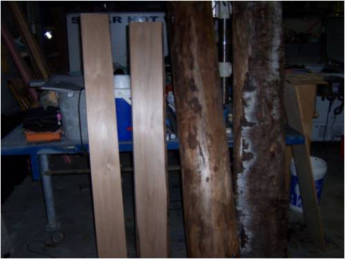

OK so far the turbine is made except for the tail but thats no big deal the timber for the blades was bought from the australian timber traders in mossman Photo shows before and after all this timber is normally left to rot so I got 6 pieces for $20 I am more than happy with the end result after some processing buy me after work today. Wish I had more time to spend on this but like everyone work comes first.Next step is to carve the blades.should spend more time working on the progect instead of in the back shed but you know how it is ,more to come soon Mick

Great work Mick. Have fun with those blades. The timbers looks good. From the pic I'm guessing you've dressed two down from the rough, like those on the right. Stick with it, Rome wasn't built in a day either.

Put locktight or locking nuts on all points, particually the stator, when you do your final assembly. We came unstuck once when the stator nuts vibrated loose and the stator rubbed on one magnetic rotor.
We use two steel discs to sandwitch and mount the blades, then nuts either side, allows easy tracking.

Lots of us are using Fisher and Paykel washing machine motors as generators here in Australia. They have a few problems starting and producing much useful energy. This means they are not suited to a standard 3 blade Piggott unless you are exposed to strong winds. We though about it here in South Australia and made a 5 blade Piggott. It starts at about the same windspeed/time as the 3 but with lots more torque. Of course it all about how much wind you have and it lacks a little speed in milder winds. However in strong winds we have difficulty controlling it. Also we have a 4 blade set being painted and this should be a happy medium for performance. All the blades are too the original specs. As to output with the 5 blades we have had 22amps at 26 volts with capaciters. Then our brush assembly fell apart and we carefully bought it back under our control. When we got it down on the ground both the front locknuts were missing and it could have been very dangerous. We now use split pins as well

I don't use split pins, but I do use Loktite removable thread lock compound. Or lately, I have found cheap lady's fingernail polish works just as well. You can buff off the remnants of it with a wire brush. Be sure to get the nuts snug against the fiberglass stator. Too tight might cause cracks, then filthy words.
Seven of my units have been based on Hugh's design. They are very sturdy and will perform well if made by the plans. However, if the blades become unbalanced, as with any generator, you will be glad you took the extra time to use thread locker or split pins.
