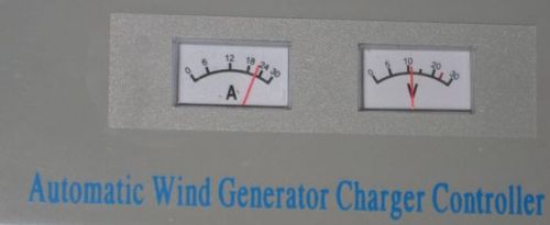

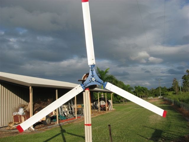

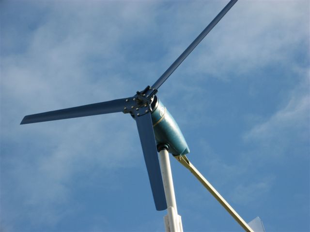

OK here's the latest, plus some photos. Again, in Davids words....
"Hi Glenn,
I will just ramble on and list it as it comes into my head. Observations to date:
Your blades have been up 6 days now
Noise levels are a little high. at higher revs the whistle gets higher pitched and can be heard many many metres away
Still some of the whine is the turbine as I don’t get it on the F & P with Chinese blades.
The reshaping definitely requires a much higher starting speed. However the start up speed here is still acceptable for me. We get wind virtually every day from 10 am till 6 pm and quite gusty.
With the original standard Chinese blades and the Chinese controller I have seen the amps stay between 4-8 and peak burst up to 18-20 amps
Now for the good news:
After about 10 in the morning the output with your blades shows 6-12 amp and quite often bursts up to 24 and I have even seen the amps go of the scale at 30 amps………The high end improvement is dramatic!!!!!!!!!!!!! (if only we could get the noise down)
This makes my 200w mill a great little beast.
Have ordered from Trev a tristar 60 amp controller with display and data logging. massive overkill but what hell its cheaper than a set of golf clubs.
That should be here by the end of the week. So I can continue with the f & P s.
Just as you said one bar the hub extender needed packing (about 30 mm out at the tip…. When I finish I will mark that one on the hub and maybe you can give it a tweak.
With standard Chinese blades at 2.5 m diameter and a 5 degree angle of attack the start up is very very poor (decogged 8sp star 12volt)
However if you increase it to 10-12 degrees the start up is reasonable but the output is poor as I can’t seem to get enough speed for a good output
I have to say so far that the Chinese mill works much better than an f & P (going by the number of people who rave over them I must be doing something wrong)
Next month will probably convert to 7 pole cogless and see if I can get these to go.
If you wish to put anything about this testing in you diary forum can you put in my own email warrendj@bigpond.net.au and say if there is anybody in Townsville who would like to see your blades and hub they can contact me and am happy to have them come round"
So there you go. As David said, if anyone is in the Townsville area they can drop him an email to plan a visit.
Looks like the blade modification only helped noise at low RPM, but has given some real gain at high RPM. Davids 200 watt windmill is making over 360 watts.

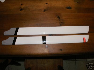

No concerted efforts experimenting on tip design yet. Most efforts are aimed at making blades with minimal resources at a low price.
However with emergence of the cheep but noisy Chinese blades, a couple of ideas have been mentioned to reduce noise levels.
I understand the glider tip as viewed in the photo is primarily an aid to stability rather than aimed at noise reduction. Though increased efficiency also occurs it must therefore reduce any noise also. Perhaps the vortex at the tip can be reduced in a more structurally simpler way?
To date, rounded tapered tips like this;
and leading edge rounded off;
have been suggested.
Even a cigar shaped tip. But to date, no trials and no comparisons.
David or Glenn,
What method is used on your blades under test above?
In the photo they still appear square tipped?

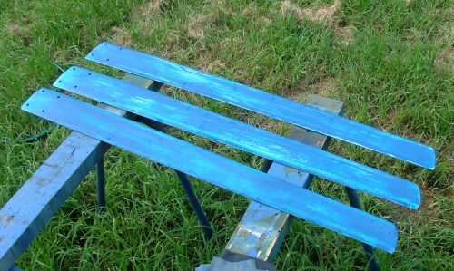

I did round the leading edge of the blades. The problem with blade noise is its very hard to find the cause, sometimes is just a simple change in profile that will either fix the problem or make it worse.
This photo was taken after the first coat of pain and sanding with wet & dry, You can see how I rounted the tips.

Thanks Glenn,
Couldn't see that in the test photo.

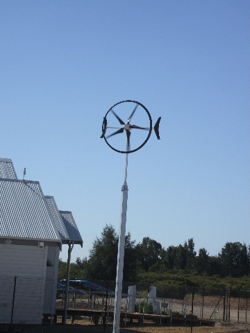

this is one of the machines installed by the SA Gov
grid connected . I have been told that the performance
has not been good but quietEdited by windman 2007-03-24

Looks like you drive along Salisbury highway near main north road as well.
It doesn’t spin as quickly as other turbines I have seen
I have never made time to stop and look at the windmill closely.
However it is in a brilliant position as far as the general public seeing a small wind turbine and becoming used to the idea.

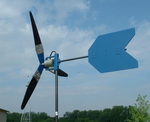

I did similar mods to some blades last year - some of which are visible/discussed here: Fieldlines link I have noticed a definate improvement in output and am working on getting some figures (unmodified vs modified) I wouldn't say mine are without noise but they are dramatically quiter than the unmodified blades and don't 'whistle'. I have had one turbine mounted on a fence approx 15m from the house and it has never been a noise issue (exposed site with plenty of wind). The turbine runs much faster which I think better suits the under spec'd alt. Logically you would think that faster blades come at the expense of harder startup but it hasn't been an issue for me

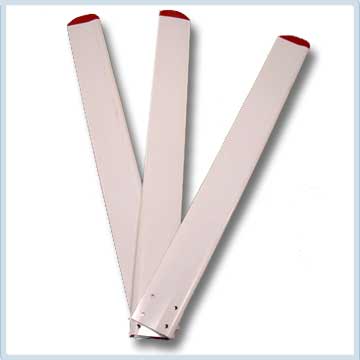

Hey Glen, I noticed this on egay, the new chinese blades are aluminium.
They also said this
"The 200w Aero now features aluminium blades (with curved ends for improved efficiency)"
It's a bit hard to see in the photo, but it looks like they still have no twist.
Did the fibregass ones have that ridge on the leading edge?
Edited by Highlander 2007-05-29
